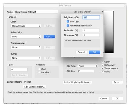

You can combine image props for the crowd with symbols for the wrist
bands. You would need a separate symbol for each color, and you could either place a point source in the symbol or use a glow texture. Doing something like a pixel map might push the limits of VW and be best done by a visualizer.
There is one way to simplify a photoshop compost. For each wrist band, apply a glow texture that does not emit light. Set the texture’s color to something close to a chromakey green (magentas can work well too). Once exported to PS, use the magic wand to select all the chromakey pixels and create a mask (either use a layer mask, or just delete). You can then lay in an image or just paint underneath that will color the wrist bands.

You could place a ton of simple extrusions (square) around the arena, assign each a glow texture that has been set up receive it’s color from “class”, create several classes for wristbands, assign sections of the extrusions to those classes and there you go. Change class colors to change colors of the various selections. Adjust to colors or even use black to adjust intensity.
 The most time consuming part would be making them look fairly random.

With glow and indirect lighting it's not too bad at all compared to regular Light sources. (Unless you switch on Lit Fog)
Share this post
Link to post
Rendering 2200 bracelets on medium settings without them emitting light took just over a minute on my machine.
