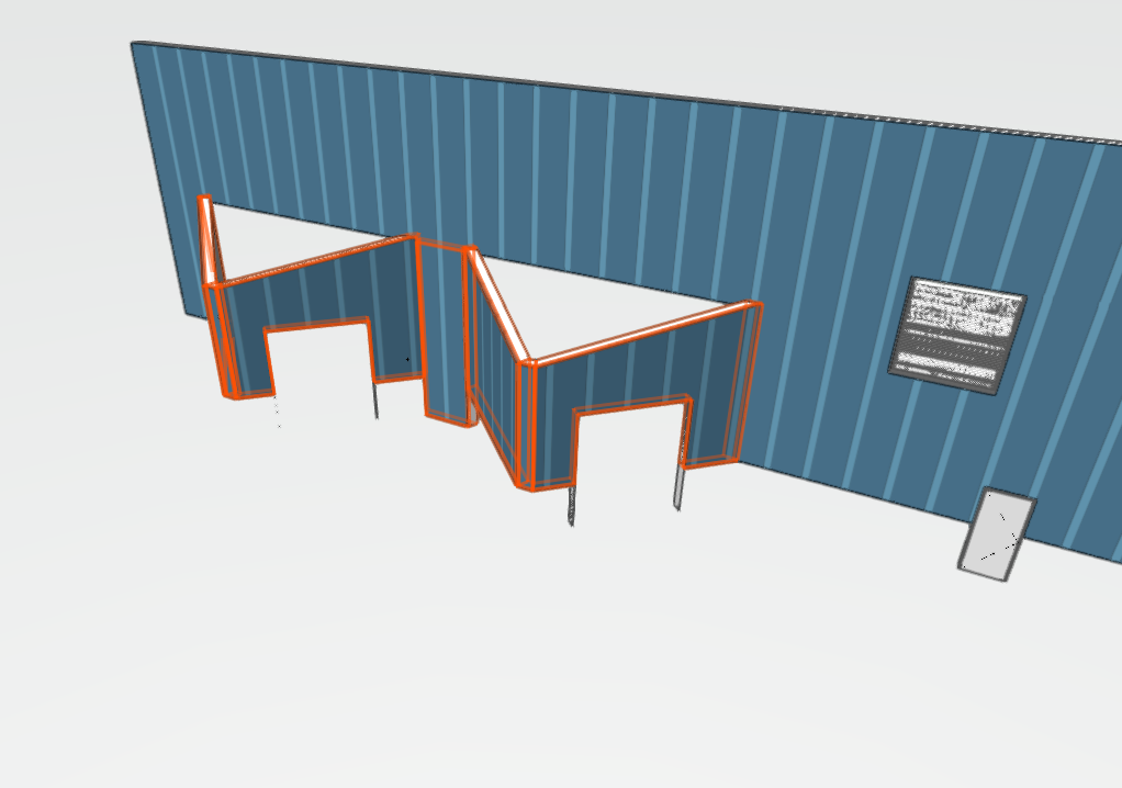

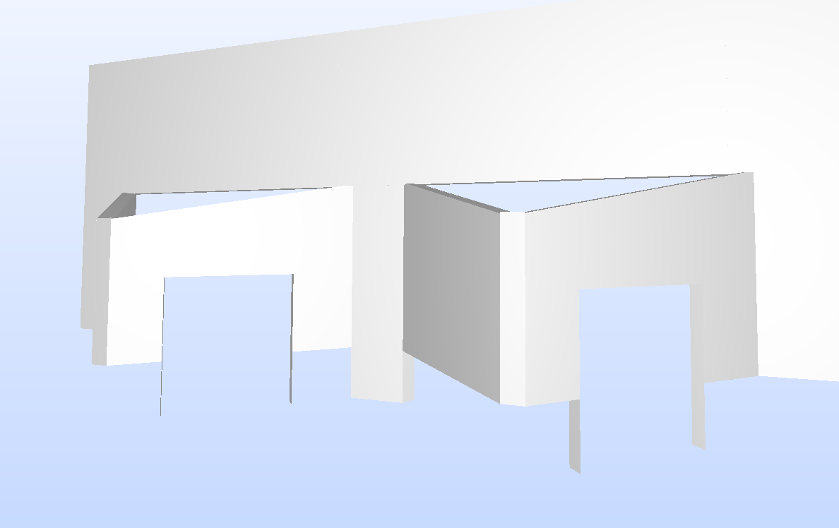

Any ideas as to how to make the following walls export correctly from VW.  I have tried shaping the walls.  Creating a feature in the walls.  Setting walls to different IFC layers, but all of the exports look like this.  The last portion of the wall seems to disappear.

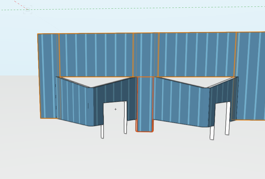

Ok.  I had to keep chopping up the offending walls so that they would export.  What should have been one wall with an opening, had to be turned into 6 walls.  I would love for the wall tool to be completely overhauled so that it is truly 3D.
