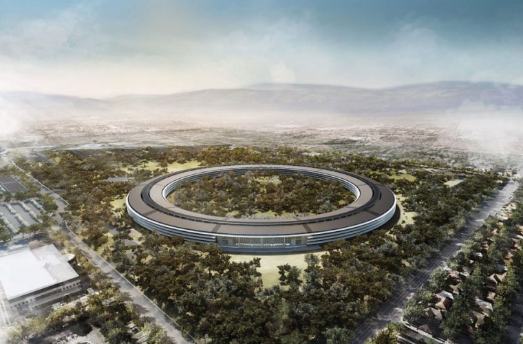

zeno Posted February 22, 2018 Author Share Posted February 22, 2018 20 hours ago, Wes Gardner said: Hi All, I think the decision was made in the design process of the curtain wall to purposely create segments as this is the way a large majority of curtain walls are built. These days curved glass is a rare bird indeed...not unheard of but a bit spendy! Modeling the required curves is probably your best bet... Wes Hello Wes I'm honored to receive an answer from you, I follow your webinars for almost a decade. I understand the priority of construction process. But I think that in a design process the best way is creating what you need to create. If we were to draw everything that is already there, we would not be architects, do you think? And if I draw a curved wall I should have the chance to generate curved glass. I'm not a software engineer, but I do not think is something difficult to define. Of course, I can create an auto hybrid element and resolve my problem in my way. But these things are exactly the things that may you think "why others BIM softwares can do this?". We are talking about a curved glass on a curved wall, not generating a bim model by scanning a sheet of paper. 1 Quote Link to comment
