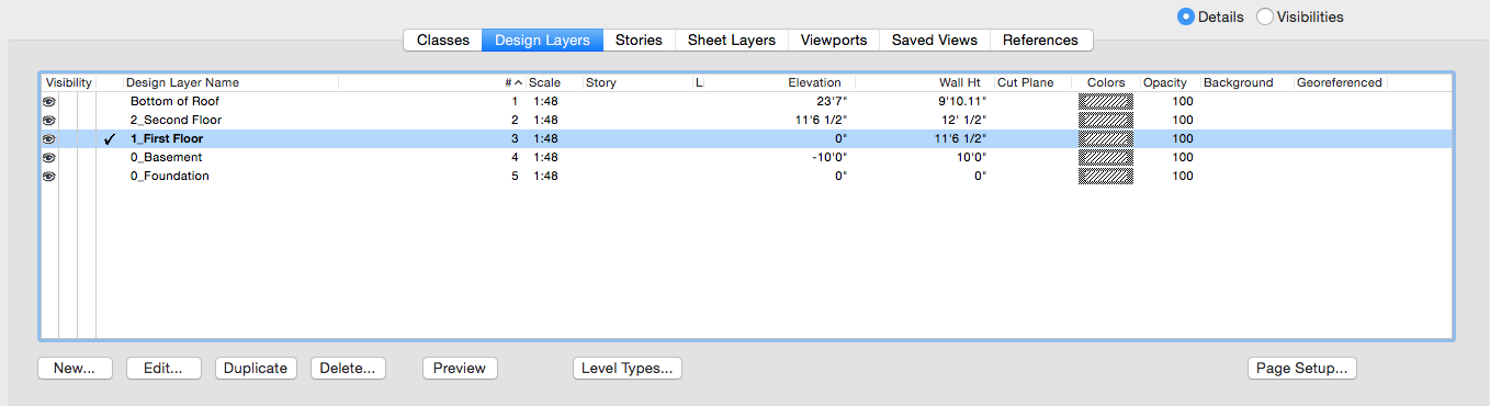

That doesn't seem to work for me.  It offset the objects by my layer height elevation. I am in VW 2018 SP2.  Is there a preference somewhere that I am not seeing.
5a3ac2b45ddc3_ScreenShot2017-12-20at3_05_06PM.thumb.png.0181c329d7e2e9829f22e6fe306b48da.png

Zoomer, I saw your posts about this.  I was hoping there might be some super smart paste plugin or script that could magically address this shortcoming (aka feature) of the program.

I've been asking for this forever.  Having a script is a good idea, cberg.  When I have some free time (i.e., probably never!) I'll look into it.  It would be a simple matter of getting the z layer settings from the 2 layers and moving by the difference immediately after pasting in place.
