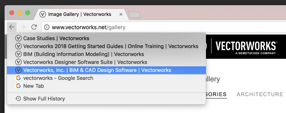

Question
I use the Previous View and Next View buttons occasionally, but they would be more useful if I could quickly jump backward or forward multiple views. Most modern browsers have implemented a press-and-hold back button to view recent browsing history. Here is an example from Chrome.

It needs to jump back through layers, sheets, and views to be useful. The current functionality is to click step by step backward (or forward) through view changes. This includes every zoom, pan, orbit, and navigation between design layers and sheet layers and can be really tedious. I would love to click and hold to display a menu, similar to a browser, that will jump back to a previous design layer or sheet layer without stepping through all the tedious zooms, pans, and orbits. This would all users to jump between layers, sheets, and views more quickly while still retaining current functionality.

Here is a common scenario: I'm working on a detail on a design layer. I want to check a dimension on another design layer, so I click that layer, pan and zoom to find what I need, check a dimension, then jump back to my original design layer. Currently, I might click, zoom, and pan five or ten times to get that dimension, then have to back up through all five or ten view steps to get back to my original design layer. A single jump back to the original design layer would be incredibly useful.

It might just be a dropdown (when you click and hold the Previous View arrow) which has a list such as:
  • Zoom Out
  • Zoom Out
  • Pan
  • Change Active Layer
  • Zoom in
  • Change Class Visibility
