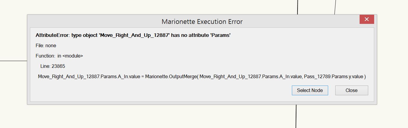

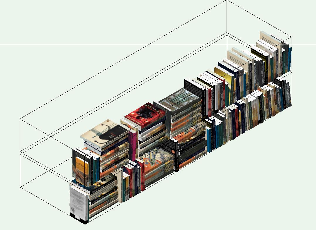

Stephan Moenninghoff 381 Posted January 9, 2017 Hi everyone, First of all: thanks for all the helpful threads and sample code that I was able to download from this forum. I have been putting together a marionette that pulls book symbols from a folder and places the symbols on a shelf. The script randomizes the books and allows for leaning books with some presets to choose from (random angles, leaning incrementally, all upright etc. You get the idea :-) ). I have now begun to introduce stacks as well. It is all going very well and I am enjoying working with marionette. Until I try to wrap my (fairly large) marionette. Sometimes, VWX will let me wrap everything and I get no errors. Sometimes, I get an error when I try to wrap. I then unwrap and the errors continue. Wrapping the same script on a duplicated layer with no changes made may or may not work. If it works, it will continue to work without a hitch. I have spent hours trying to debug errors of the type "Attribute Error: type object 'Move_Right_And_Up' has no attribute 'Params'. These always point to wrappers within the marionette network but I can see nothing wrong with them. There were some threads dealing with similar errors but none of the solutions mentioned seem to work in my case so, I guess it's time to ask for help. I attach a rendered scene with version 0.5 of the books (no stacks yet) and a dropbox link to the latest version of the file in case anyone wants to have a look. Each design layer contains exactly the same marionette with some of them throwing errors, and others working fine. I have labeled the design layers so it is easy to see which is which: https://www.dropbox.com/s/p0zyvf9kwxz10ao/Books (Stable%2C with Flat books v. 0.9).vwx?dl=0 Thanks! --Stephan 4 Quote Share this post Link to post
sbarrett 217 Posted January 9, 2017 Hi Stephan - I am having trouble downloading your file, but from how you describe what is happening, I think this is a bug. There is a bug that I am aware of when you run a wrapped network for the first time after you have duplicated it by duplicating a layer, and usually, this only happens once for each wrapper in a network. This sounds like what you are talking about, but there may be something else involved too - if you can, please file a bug with Vectorworks. btw, this sounds like an awesome script! Quote Share this post Link to post

AlanW 522 Posted January 10, 2017 (edited) @Stephan Moenninghoff Hi, Downloaded (took a few minutes) all ok time goes up and down but watch the download amount and it streams in ok and runs easily and gave me random books on the shelf and then wrapped it up and it works wonderfully. The attached are 2 Objects with different title books. I wondered why it too about 30sec to copy a block and it turned out to be in 3D WOW. I see the errors and crashing and will have a look. Love it. Lot of work there, Great to see new faces in here and doing such great work. Edited January 10, 2017 by Alan Woodwell Quote Share this post Link to post
AlanW 522 Posted January 10, 2017 (edited) Hi adjusted and added one node and not crashing but still has issues of divisible by 0 Down to this error now. Your Get 3D Info nodes in the top row are calling up ZERO so all your books now are stacking up in the left side. HTH Time for bed here will look more tomorrow. Edited January 10, 2017 by Alan Woodwell Quote Share this post Link to post
Marissa Farrell 461 Posted January 10, 2017 6 hours ago, Stephan Moenninghoff said: No luck. Still crashing. I did hesitate to report this as a bug as it may be the way I'm connecting my network that is causing the crashing. However I see no way of debugging this. Hey Stephen, I just wanted to let you know that I looked over your bug report and I do see the crash on Mac, but I'm not getting a crash on Windows, which is why Alan is able to play around with your network further, but you aren't. I'll make sure our engineer takes a look at it and hopefully he can find where the issue is. I'll try to take some time later to debug as far as I can go on my own. There are probably some other underlying issues in there somewhere, most likely wrapper errors which we don't see often enough to determine what the issue really is. Quote Share this post Link to post

AlanW 522 Posted January 10, 2017 @Stephan Moenninghoff Hi, couldn't add more last night as VW Server kept crashing. What I wanted to say was you 3D of each book, some have upto 732 3D polygons which will slow the average computer and cause slowness as you add more shelves of books. You will need to simplify the 3D books so the file size is smaller and things run faster. The funny thing about the "get list length" node was the program crashed if i touched this one and any either side of it but could move all the other nodes. Once i replaced it with 2 and got it working I was able to go back to the single node feeding both and no issues. HTH Quote Share this post Link to post
Stephan Moenninghoff 381 Posted January 11, 2017 17 hours ago, Alan Woodwell said: What I wanted to say was you 3D of each book, some have upto 732 3D polygons which will slow the average computer and cause slowness as you add more shelves of books. You will need to simplify the 3D books so the file size is smaller and things run faster. I can't see any difference in performance on my end between books consisting of meshes and books modeled in VWX. If you have time, would you try using the Penguin paperback collection instead of the Paperbacks? Does that make a difference on your computer in terms of execution speed? BTW the reason why I'm using the meshes is I made them outside of VWX (in an app designed to do just box shots of objects) and then imported them via OBJ. The UV mapping of the textures will get destroyed once I enter the mesh. Quote Share this post Link to post
