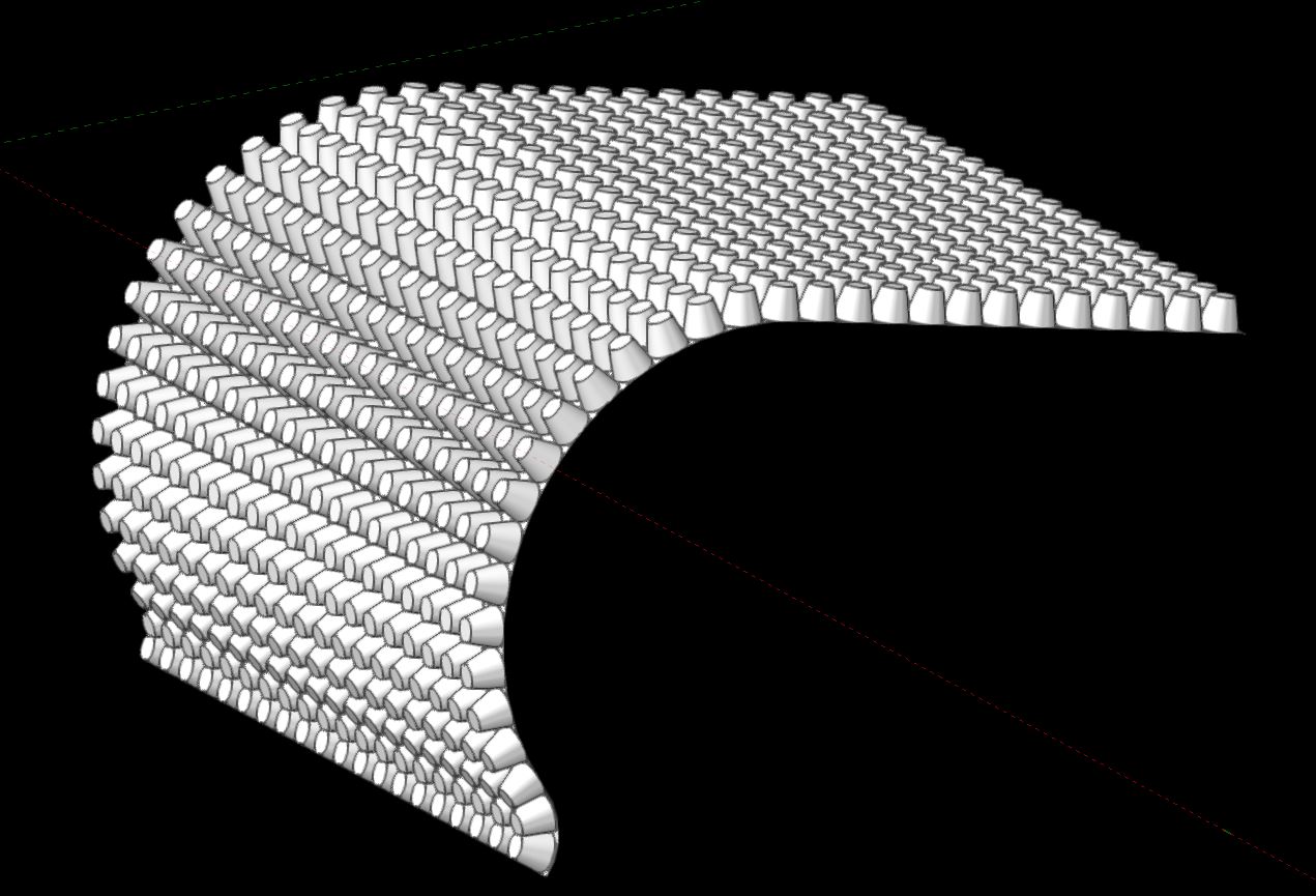

James Russell Posted March 13, 2015 Share Posted March 13, 2015 It is possible, see attached. I think your issue must have something to do with your base surface shape. I've used a sphere and parts from a cone that have been converted to nurbs surfaces. I'm more interested in how you've managed to do yours... J Quote Link to comment
Benson Shaw Posted March 13, 2015 Share Posted March 13, 2015 (edited) Horsing around with a similar setup. Base Surface: Two concentric circles on Layer Plane. Convert to NURBS. Raise z of smaller one. Loft Surface. Source object: 2 Extruded hexagons. @Laura - I think the x' and y' offsets need adjusting, and toggle through the Edge Condition options near bottom of OIP. If the offsets are correct, the array should not overlap. @James - I have best success with hex grids if the source profile is two units with one coincident edge. This fills the interstitial areas with rotated object instead of space. Single hex can also work if offsets and shifts are adjusted. HTH -B Edited March 13, 2015 by Benson Shaw Quote Link to comment

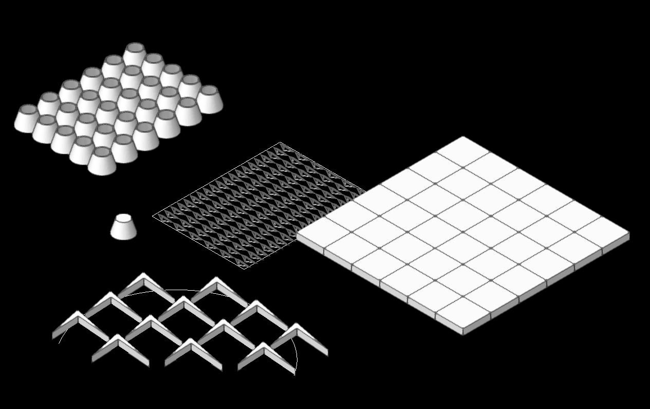

AlanW Posted February 28, 2017 Share Posted February 28, 2017 (edited) @vincetang20Hi, you can use a variety of base surfaces. Here i have drawn a few different objects and different base surfaces and hit Model Surface array after selecting both objects an I get these results. Maybe this is not what you are after??? Certainly as Jonathon said if you were after a curved surface you would need to use a Nurbs surface as the base. Edited February 28, 2017 by Alan Woodwell Quote Link to comment
