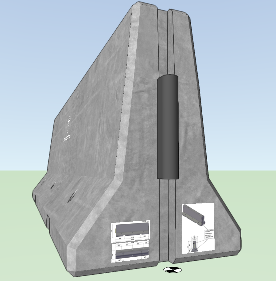

if i were modeling engines, transmissions, and machinery then solid works is the way to go (actually i would get onshape.com)  but anything that has a building, landscape, IKEA flavor to it...i would use VW
the reasons.  please take a look at attached images below.  all done in VW.  i needed to not only model what you see below (not that complicated) but i needed to pull back and show Concrete foundation, steel building, landscape (DTM, trees, cars,)
also i have been adding text labels or images to all my objects (see the images i have inserted into my Jersey Barrier symbol) this cannot be done in solid works or onshape.
i use  these images and/or texts inserted into the model to help me explain the model to people in a goto meeting.
here is a video showing the value of inserting 2d plane images.  so programs that can't do this are a deal breaker for me
