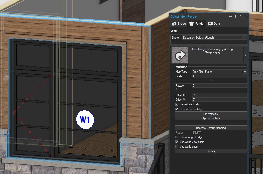

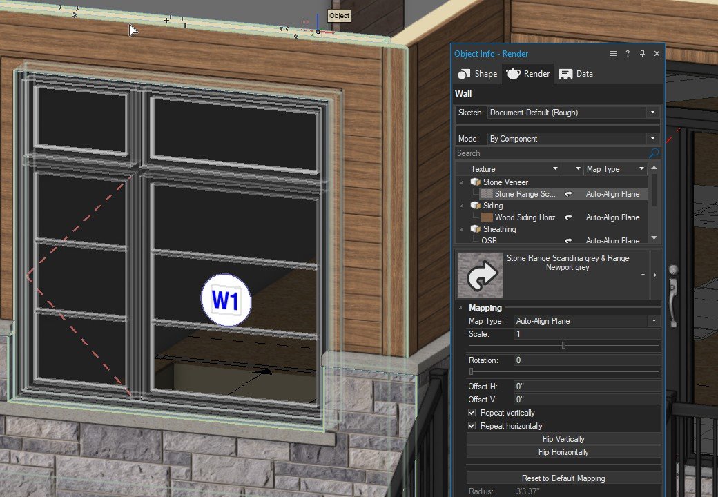

Markvl Posted May 6 Author Share Posted May 6 For some reason V2026 does not give me a "MODE" option. See pics. Pic 69 is from V2025 and Pic 70 is from V2026 Quote Link to comment
Markvl Posted May 6 Author Share Posted May 6 Weird. The help section suggests that there should be a Mode section in the palette. Quote Link to comment
Tom W. Posted May 6 Share Posted May 6 Have you tried restarting VW? You should definitely have the Mode drop-down. Is it the same with every Wall in every file e.g. in a new blank file? Quote Link to comment
