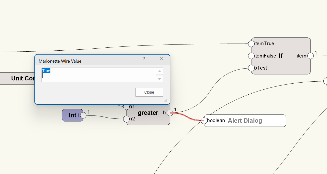

Wire debug value doesn't match node input value
Posted (edited)
It was:
@Marionette.NodeDefinition
class Params(metaclass = Marionette.OrderedClass):
	# APPEARANCE
	this = Marionette.Node('Alert Dialog')
	this.SetDescription('Displays an alert dialog to the user.')
	# Input Ports
	runFlag = Marionette.PortIn(False, 'boolean')
	runFlag.SetDescription("If False, the alert dialog will run")
# BEHAVIOR
	this.SetListAbsorb()
def RunNode(self):
	# inputs
	run_flag = self.Params.runFlag.value
	# script
	vs.AlrtDialog("Greater than value is "+ str(run_flag))
Edited by Ben Garcia
Link to comment
I have no idea. I just tested your node in a less complicated network and I get the same output between the debug and the node.
Try something like the above and see if you can get the failure.
One a separate note, you might want to rename the Node to something like Alert Dialog 2 since there is already a default Alert Dialog node that does something different.
Link to comment

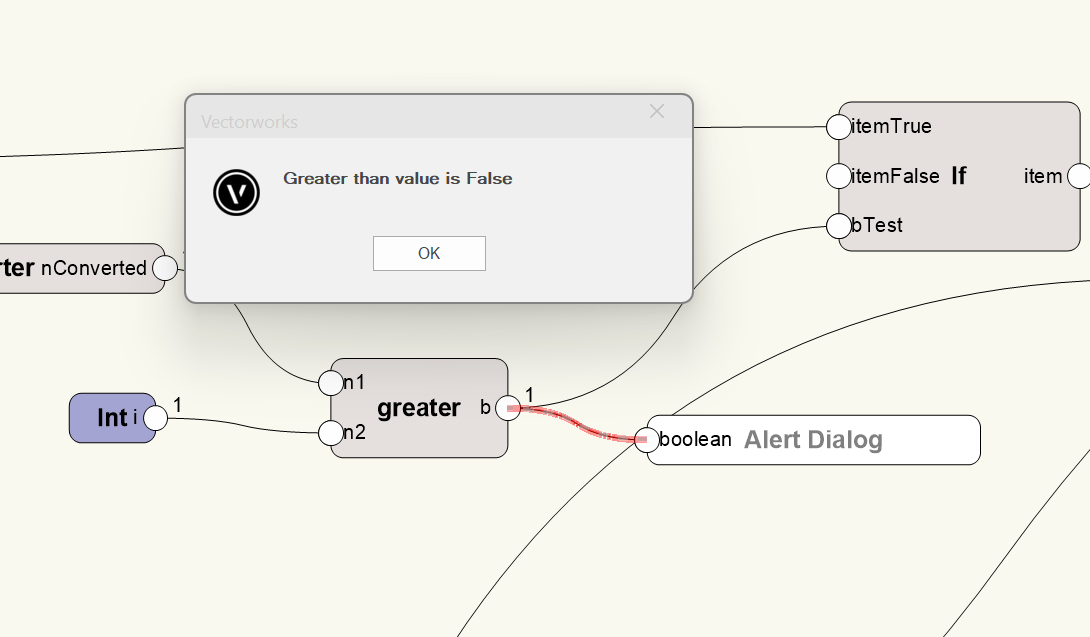

  • Marionette Maven
7 hours ago, Ben Garcia said:
It was:
	# APPEARANCE
	# Input Ports
# BEHAVIOR
def RunNode(self):
	# inputs
	# script
I think while trying to debug you got yourself all out of sorts here.
The issue, though, is the
line.
What this does is it takes everything that is wired into the port and takes it in as a list, so the boolean input you're receiving is actually
[True]
or
[False]
Two ways to resolve this -
1) take out the
line.
2) change
	# inputs
to
	# inputs
	run_flag = self.Params.runFlag.value[0]
________
I imagine you want it to behave more like the following in the long run:
	# APPEARANCE
	# OIP Controls
	txt = Marionette.OIPControl('Text', Marionette.WidgetType.Text, '')
	txt.SetDescription('The alert message to be displayed')
# BEHAVIOR
def RunNode(self):
	# inputs
	text = self.Params.txt.value
	# script
	if not run_flag:
		vs.AlrtDialog(text)
  • Like 2
