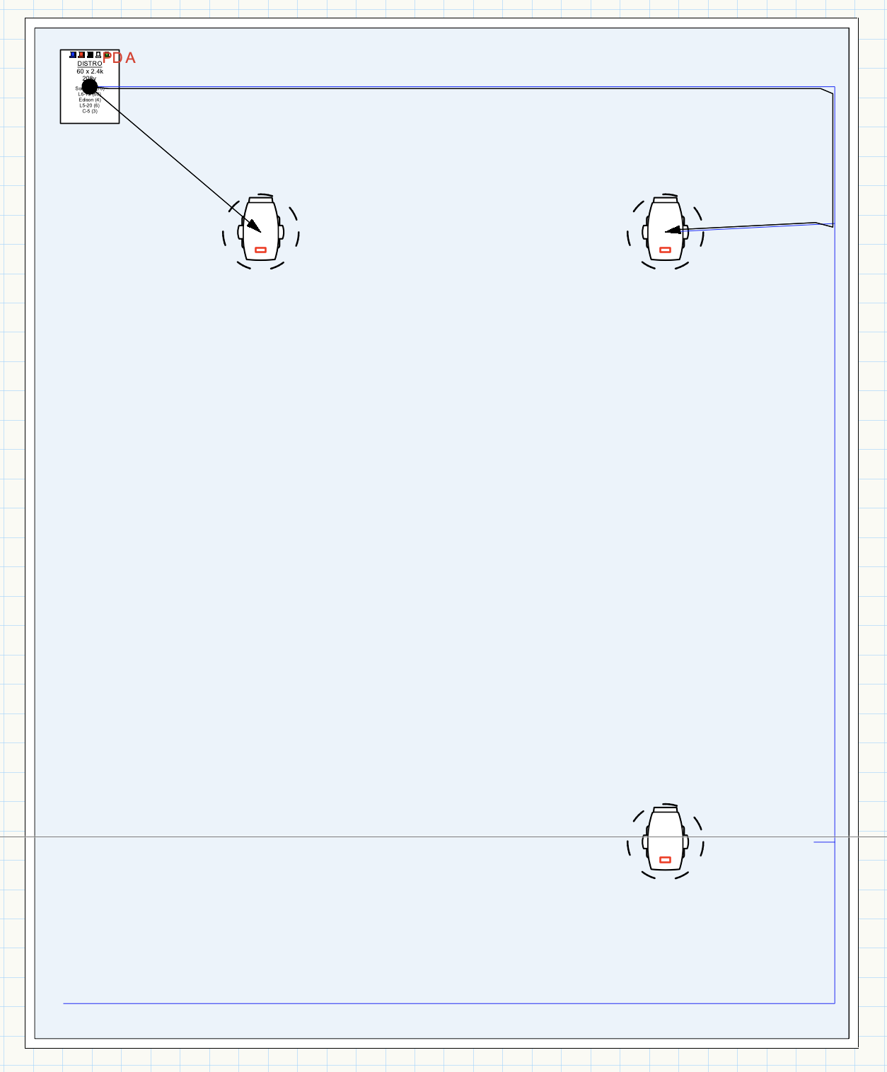

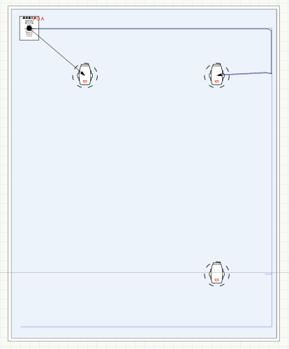

I've attached a file so you can see what I mean. First I ran a cable path around the room and dropped a few fixtures to test.
The first fixture, as you have probably seen, just shot a line direct to the distro. Not what you want.
The second fixture (upper Right) I drew a Cable Path that connected to that light. Gets me the proper run, but a lot of Paths to draw.

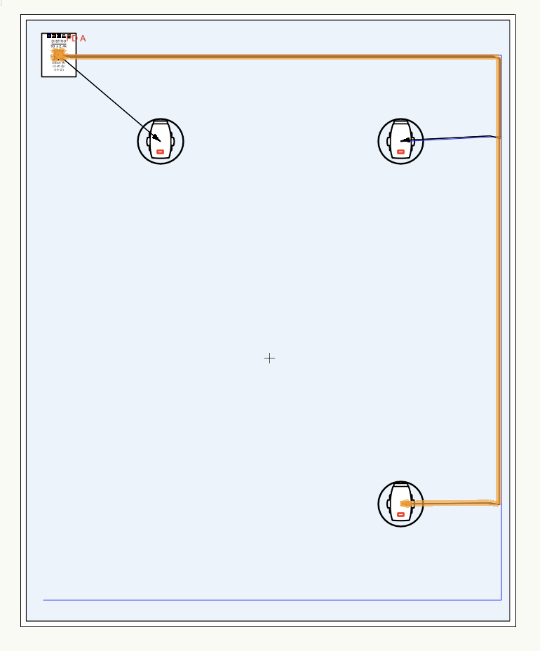

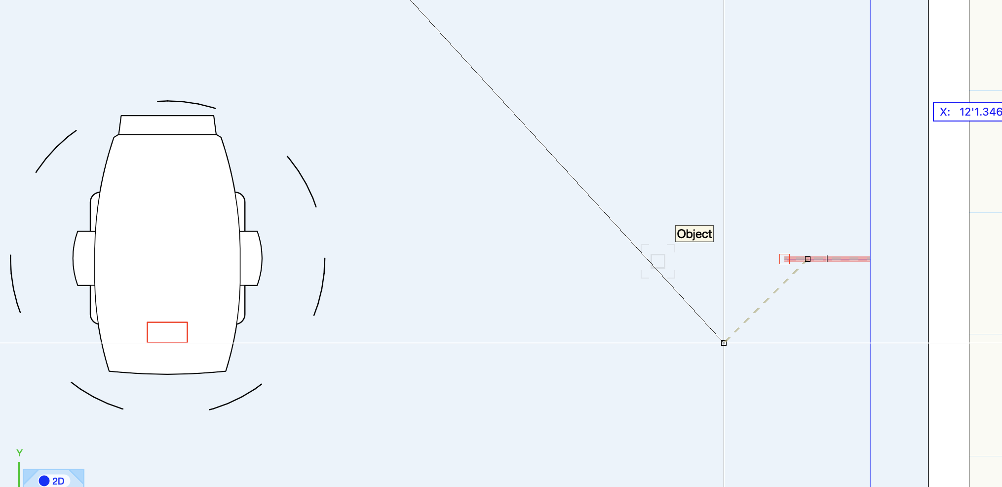

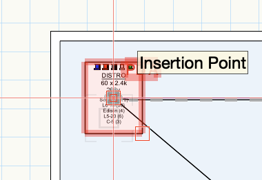

For the last fixture (lower Right) I just dropped a small spike on the cable path. When I drew the cable I started at the distro:
Then ran straight down to the "spike" (note the Red line to indicate the cable will connect to that path)
From there I dropped the cable on the fixture and got this result:
Is that what you're looking for?
