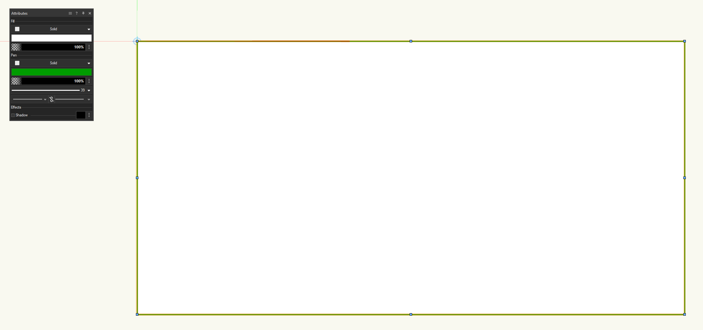

Jesse Cogswell Posted April 6 Share Posted April 6 (edited) What are your fill settings when you run the script? You don't specify a fill color in your script, so it's likely using your active fill color, which may very well be black. If you want it to be white, you would need to add SetFillBack(LNewObj,65535,65535,65535); Also, keep in mind that color 0,0,0 is black, 65535,65535,65535 is white. The color you specified in the script above is a very dark green, practically black. Edited April 6 by Jesse Cogswell Quote Link to comment
Jesse Cogswell Posted April 6 Share Posted April 6 Adding an extra 0 to your color script (as in 40000) will produce a rectangle like this: 1 Quote Link to comment
grant_PD Posted April 6 Author Share Posted April 6 @Jesse Cogswell that did the trick! 1 Quote Link to comment
