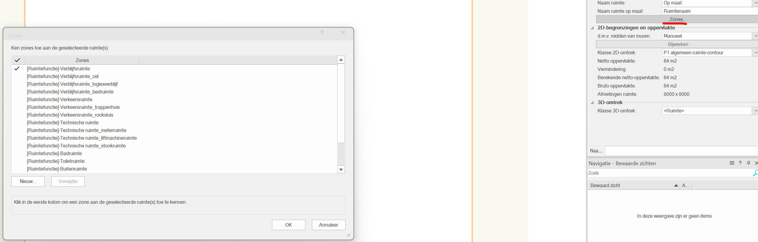

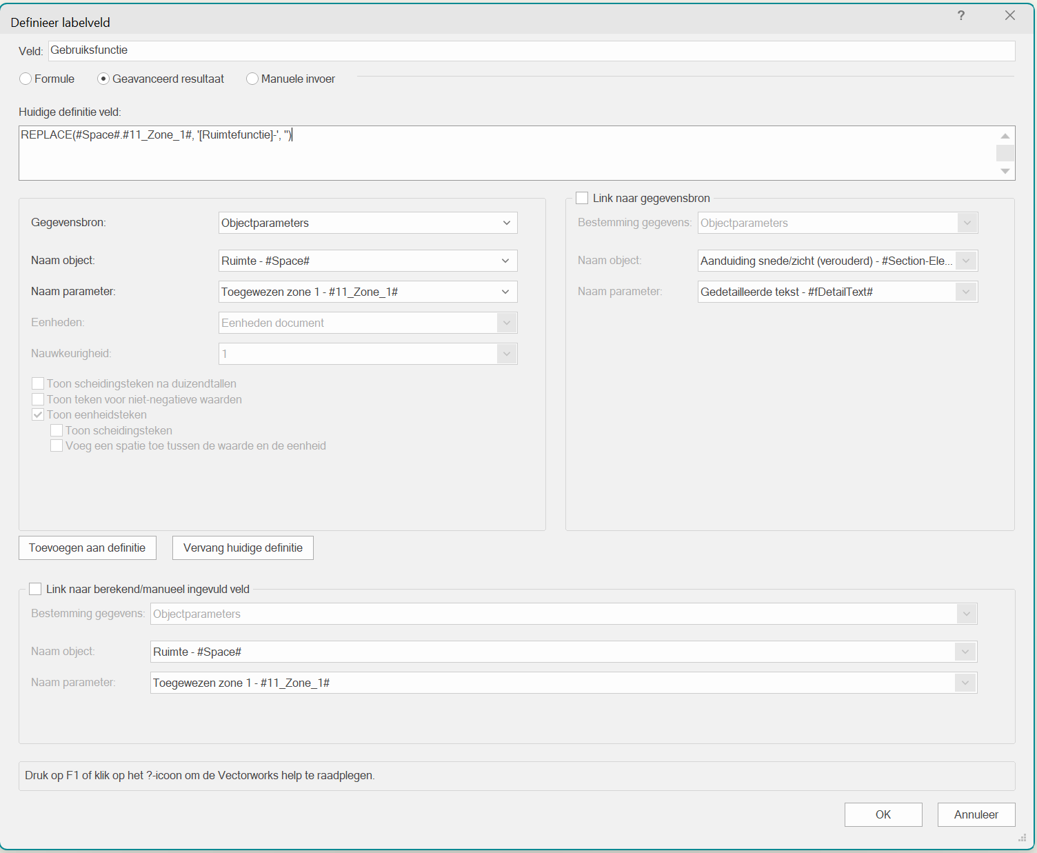

MarcelP102 Posted March 9 Share Posted March 9 Is it possible to strip away a part of the value of the data tag? We uses 'zones' in de rooms to define the function of the space. The default output shows '[Ruimtefunctie]-Verblijfsruimte' I want it to show up as 'Verblijfsruimte'. Could this be done with a script in the data tag like: REPLACE(#Space#.#11_Zone_1#, '[Ruimtefunctie]-', '') Unfortuantly this is not working.. Any help? Quote Link to comment

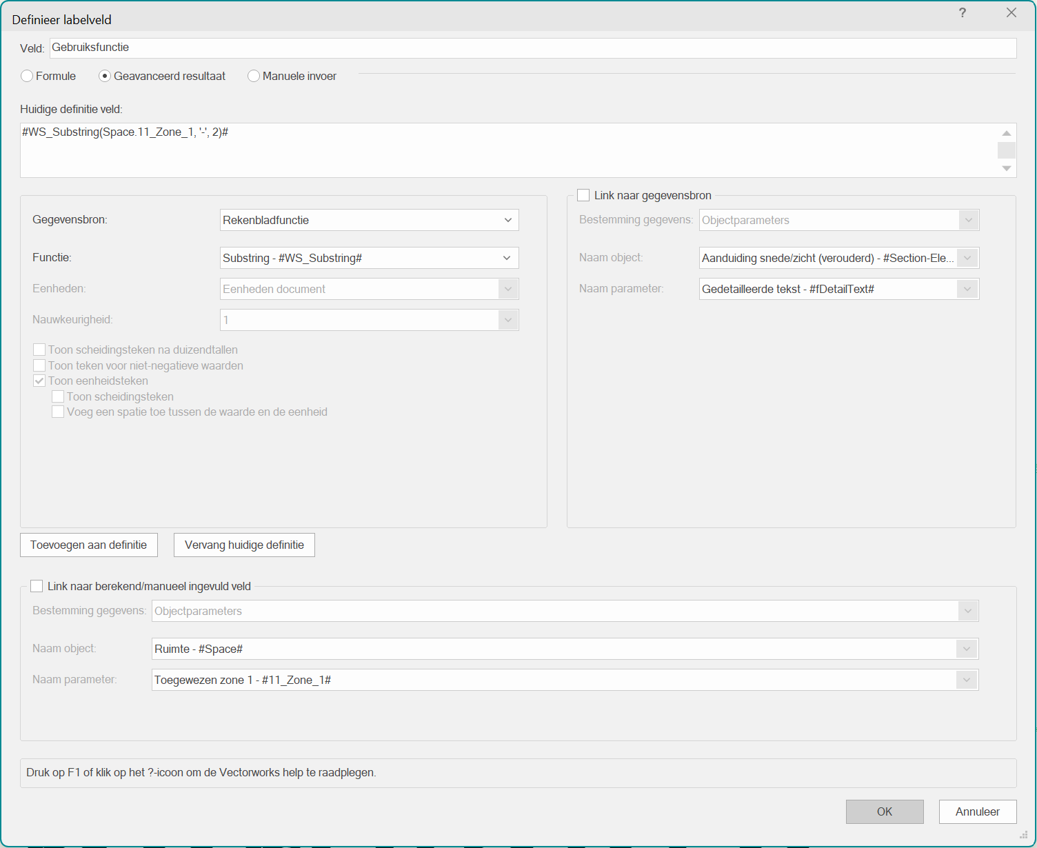

Pat Stanford Posted March 9 Share Posted March 9 Try #WS_Substring(Space.11_Zone_1, '-', 2)# This should return the second part of your string after the dash. If you have multiple dashes it will only return the second part. Note that inside the #WS you have to use pure Worksheet format, you can't use the Data Tag # versions. Quote Link to comment

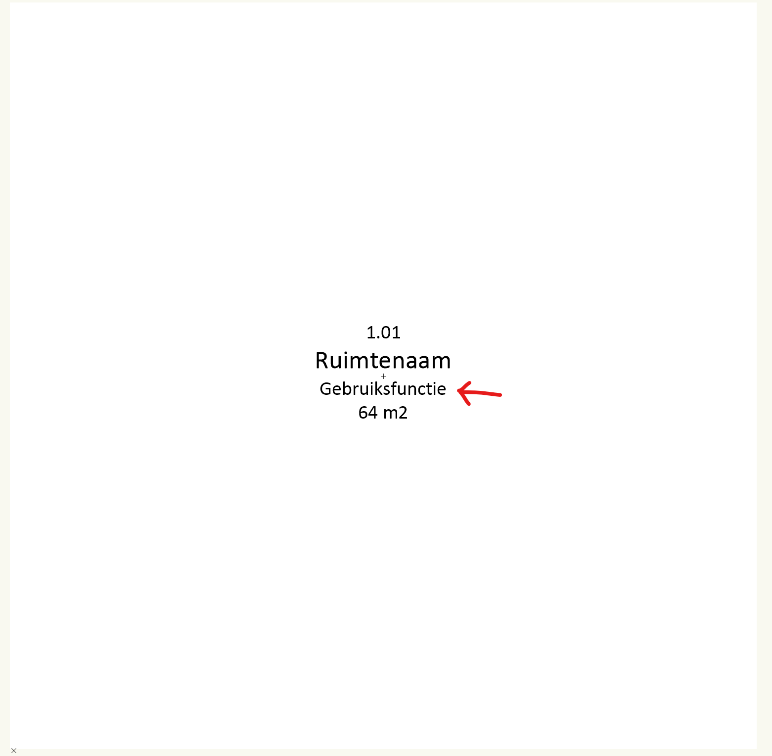

MarcelP102 Posted March 9 Author Share Posted March 9 Hi pat, Thanks for your replay. Shomehow it doent show the value but the title of the labelfield. See attachment for sample file. Apreciate it a lot if you could take a look. Data tag mistery.vwx Quote Link to comment
Pat Stanford Posted March 9 Share Posted March 9 No idea. I opened your file and saw the wrong value. I then edited the Data Tag Style and the Layout. I selected the placeholder text and clicked the Define Tag Field button in the OIP. I noted that the formula was what I expected. When I exited the Tag Style, the value updated to what we expected. Please try the above. And if it works, then try a new file and import the tag style and see if it works there as well. Mystery to me also. Quote Link to comment
MarcelP102 Posted March 19 Author Share Posted March 19 Sorry for the late replay. Thanks for checking. If it works for you but not for me it could be that my localized version of VW has a bug. I will wait till sp4 is out in my country and if the bug remains contact support. Quote Link to comment
MarcelP102 Posted April 28 Author Share Posted April 28 The sollution was to replace the , with ; (as your signature saids) 1 Quote Link to comment
