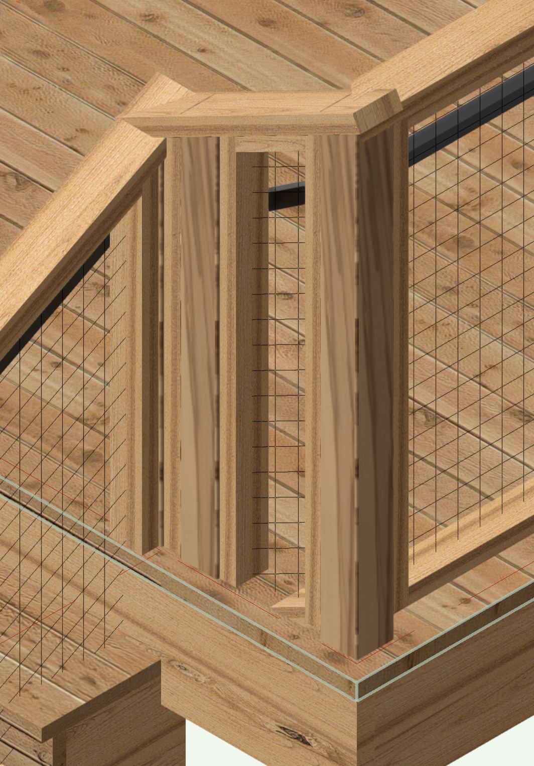

Dick Jenkins Posted March 3 Share Posted March 3 Is there any way to get the guard top rail to join properly to the deck guard top rail as shown in my screen shot? Quote Link to comment

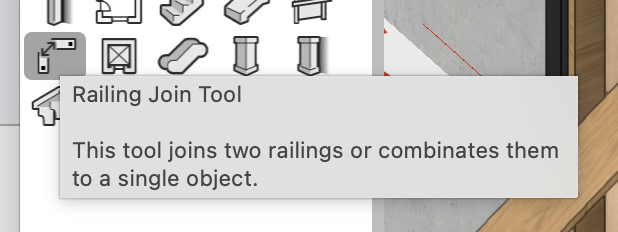

Christiaan Posted March 4 Share Posted March 4 Have you tried the Railing Join Tool? 1 Quote Link to comment
Popular Post Tom W. Posted March 4 Popular Post Share Posted March 4 Where on earth did they get 'combinate' from...?! 1 5 Quote Link to comment
Christiaan Posted March 4 Share Posted March 4 Based on my Portuguese girlfriend's ability to cross-contaminate words (across the five languages she speaks fluently), I'm going to go with somebody for whom English is not their first language writing this tool tip. If an Italian takes combinato (the Italian past participle of combine) or a Portuguese or Spaniard takes combinado (their participle of combine) and applies a standard English verb suffix, they land directly on "combinate." 😆 1 1 Quote Link to comment

Christiaan Posted March 5 Share Posted March 5 Oh! I checked the Oxford Dictionary on my Mac and couldn't find it. https://www.oed.com/dictionary/combinate_v?tl=true says Vectorworks is using an obsolete word from the 1500s 🤪 Quote The only known use of the verb combinate is in the late 1500s. OED's only evidence for combinate is from 1578, in the writing of John Banister, surgeon. 1 Quote Link to comment

Dick Jenkins Posted March 5 Author Share Posted March 5 Back to the original question. The join tool does not work on this. My rail was modeled as a continuous polyline with garvity applied. Quote Link to comment
Christiaan Posted March 6 Share Posted March 6 13 hours ago, Dick Jenkins said: Back to the original question. The join tool does not work on this. My rail was modeled as a continuous polyline with garvity applied. Dick, try modelling the stair railing and balcony railing in one go, using the Pick mode (the first one). You just select the edges of your stair and balcony and then click on the green check button in the mode bar. Quote Link to comment
Dick Jenkins Posted March 8 Author Share Posted March 8 On 3/6/2026 at 2:46 AM, Christiaan said: Dick, try modelling the stair railing and balcony railing in one go, using the Pick mode (the first one). You just select the edges of your stair and balcony and then click on the green check button in the mode bar. I thought that is what I did. It was all in one go clicking on the places on the steps where I wanted a post. Quote Link to comment
Christiaan Posted March 9 Share Posted March 9 Dick, can you upload a simplified file, with just the deck, railing and stair? Quote Link to comment
Dick Jenkins Posted March 9 Author Share Posted March 9 The model of the Stairs and Ramp is attached. Let me know if you can't open it. It is in VW2025 .VW Railing Test.vwx Quote Link to comment

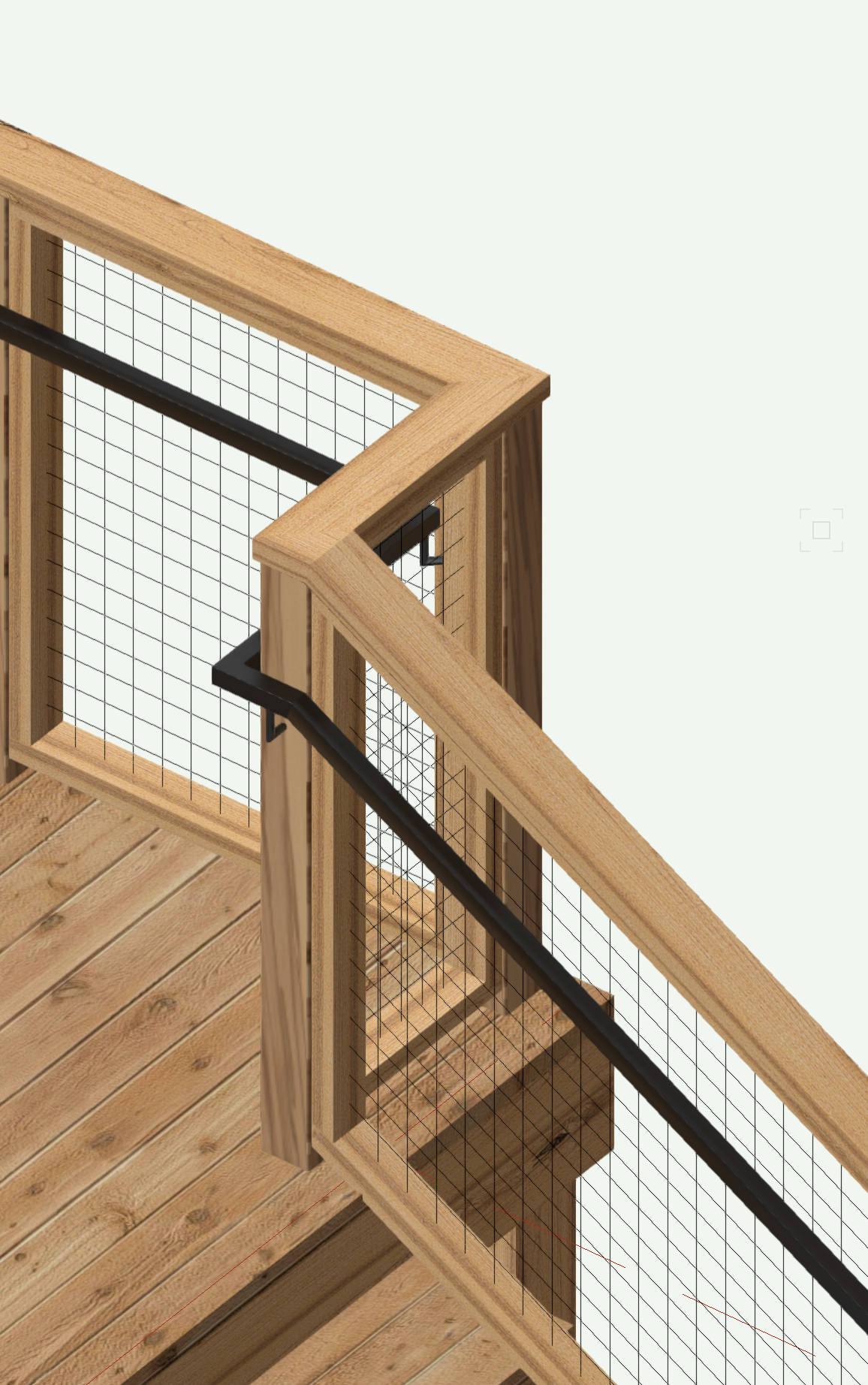

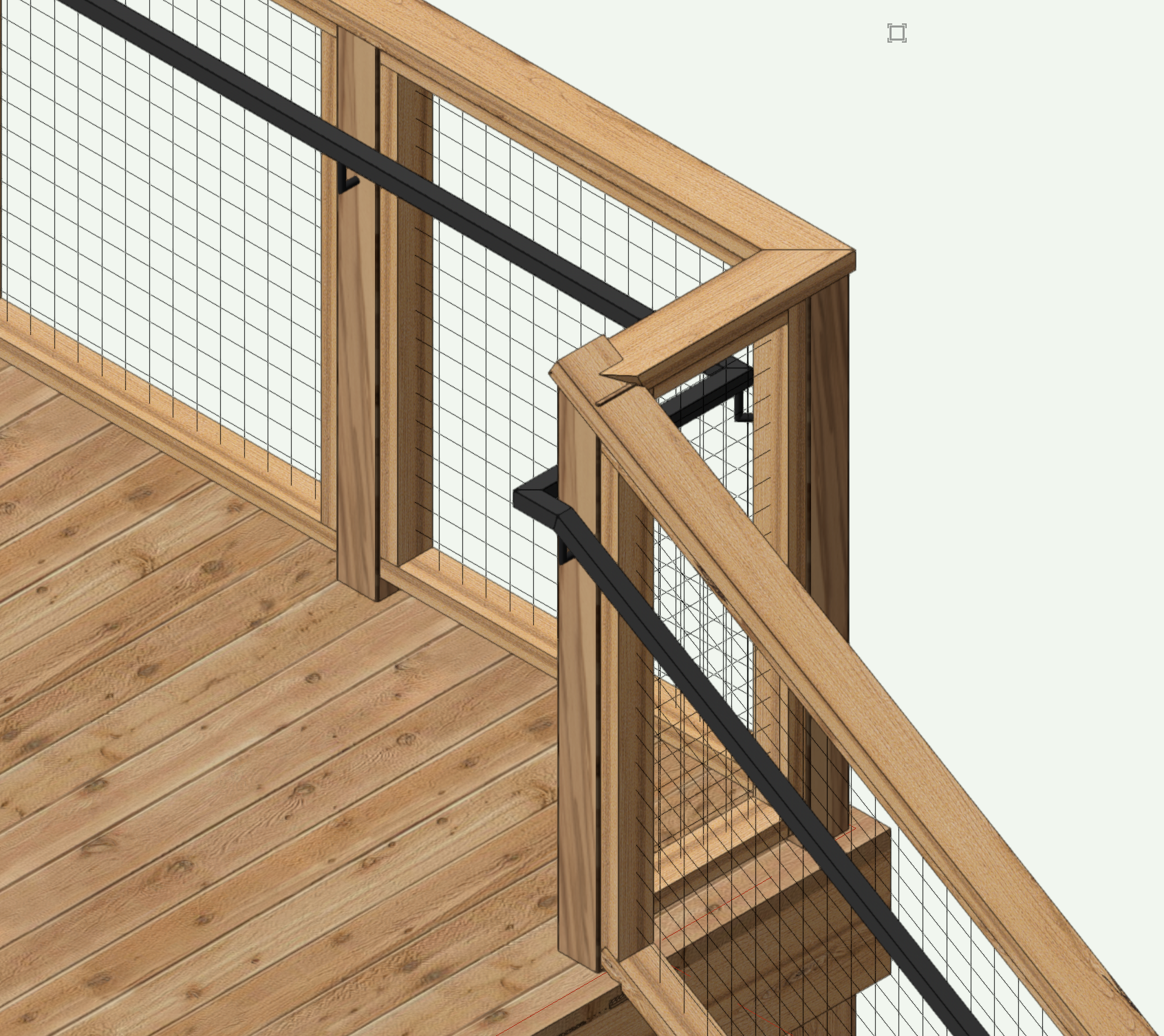

Tom W. Posted March 9 Share Posted March 9 I was able to tidy it up by moving the side panel back an inch or two so the handrail isn't having to transition from sloping to horizontal + turning at the same time: Doing this created an extra post which I deleted. Quote Link to comment
Dick Jenkins Posted March 9 Author Share Posted March 9 Could you possibly make a little movie showing me how you did this? When I try it, it just creates another post. Quote Link to comment
Tom W. Posted March 9 Share Posted March 9 12 minutes ago, Dick Jenkins said: Could you possibly make a little movie showing me how you did this? When I try it, it just creates another post. Sure: Screen Recording 2026-03-09 at 20.38.01-2.mov Quote Link to comment
Dick Jenkins Posted March 9 Author Share Posted March 9 3 minutes ago, Tom W. said: Sure: Screen Recording 2026-03-09 at 20.38.01-2.mov 39.69 MB · 0 downloads Thanks! I misunderstood the direction of "back"😆 and was instead trying to move the corner post to the side. Quote Link to comment
Christiaan Posted March 9 Share Posted March 9 Another way to resolve this kind of thing is for the top tread to be at the same level as the deck (partially or fully) Quote Link to comment
