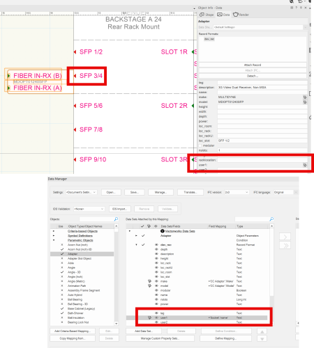

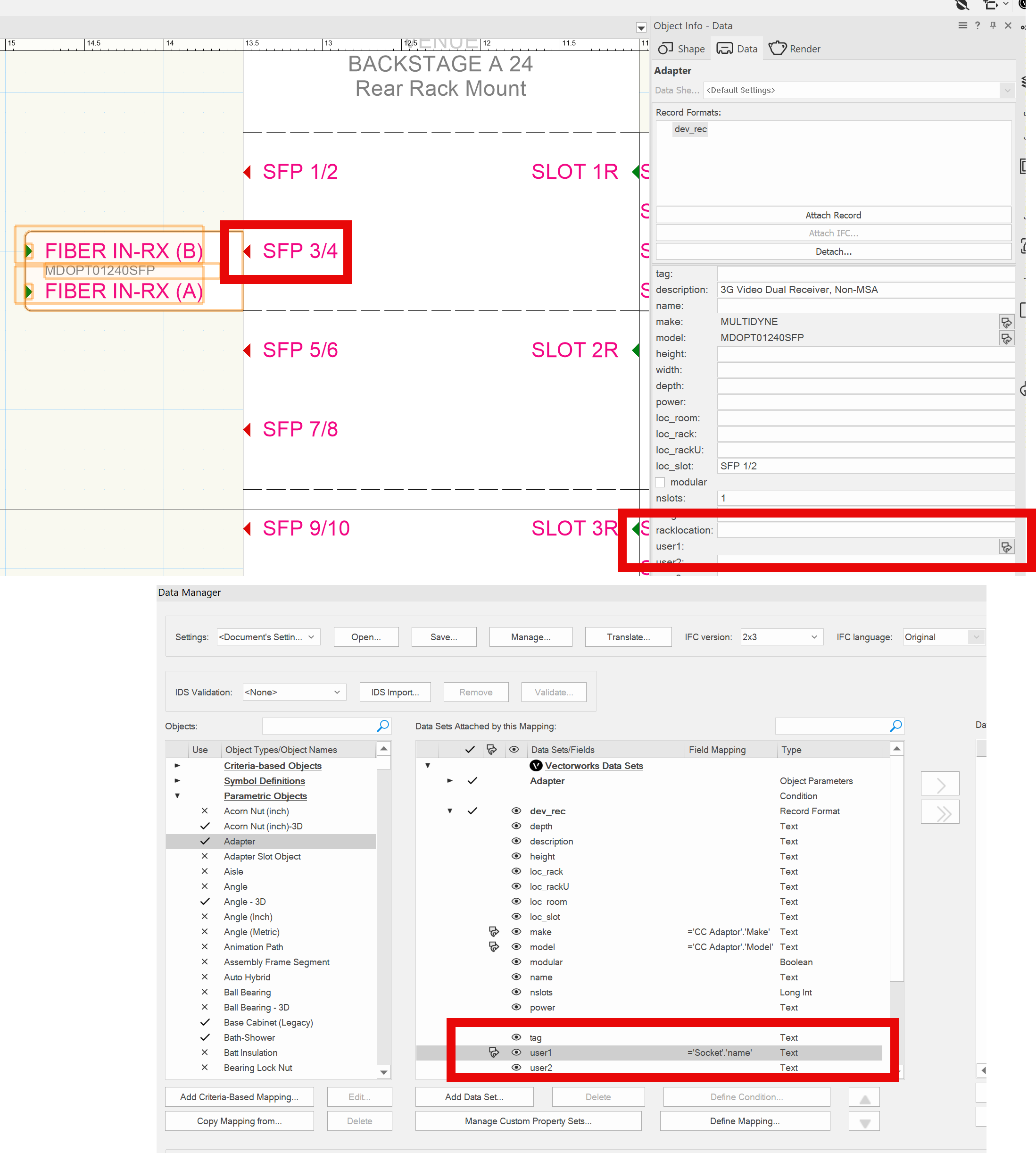

Greg Abel Posted Tuesday at 04:32 PM Share Posted Tuesday at 04:32 PM Looking to find a way to get the socket name that an adapter is attached to on a device into an attached device record on the adapter. As shown below would like to see SFP 3/4 in the Adapter's attached Device Record user field. Thanks! Quote Link to comment
Vectorworks, Inc Employee Nikolay Zhelyazkov Posted yesterday at 07:45 AM Vectorworks, Inc Employee Share Posted yesterday at 07:45 AM Hello @Greg Abel, You can use the worksheet function =OBJECTDATA('eval adapter plug socket', 'Socket', 'name') This will give you the socket name but you can also use it for any record attached to the socket object too. Best Regards, Nikolay Zhelyazkov 1 Quote Link to comment
