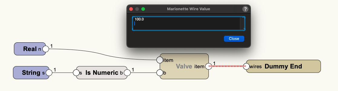

bcd Posted Saturday at 12:48 AM Share Posted Saturday at 12:48 AM Or am I misunderstanding it. I expected the False value @ b to result in a null output - here the real value 100.0 flows. Valve test.vwx Quote Link to comment
Pat Stanford Posted Saturday at 05:11 AM Share Posted Saturday at 05:11 AM @Marissa Farrell Can you comment please. I tried to take a look at the Valve script and it did not make sense to me. It appears that the output of the valve is always the item. The help says that "The network past this point will not run". And apparently self.Params.out.blocked = True. But at least an ADD node after the Valve runs no matter the True or False value on b. Quote Link to comment
Marionette Maven Marissa Farrell Posted Monday at 01:58 PM Marionette Maven Share Posted Monday at 01:58 PM Thank you, good catch. The SetListAbsorb() is what is causing the failure. I'll get a fix in as soon as I can. For now, the node in this file works. valve_fixed.vwx 1 Quote Link to comment
