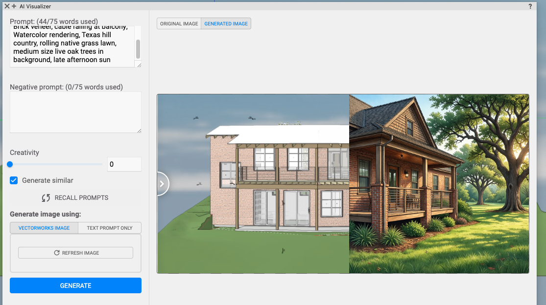

Phil Schawe Posted Friday at 10:29 PM Share Posted Friday at 10:29 PM I have used this tool in the last few months with great results. Today, however the Visualizer is rendering one-half the screen by using only my text prompts, and the other half is just my original VW image unchanged. Any ideas? Phil VW 2025 macMini Quote Link to comment

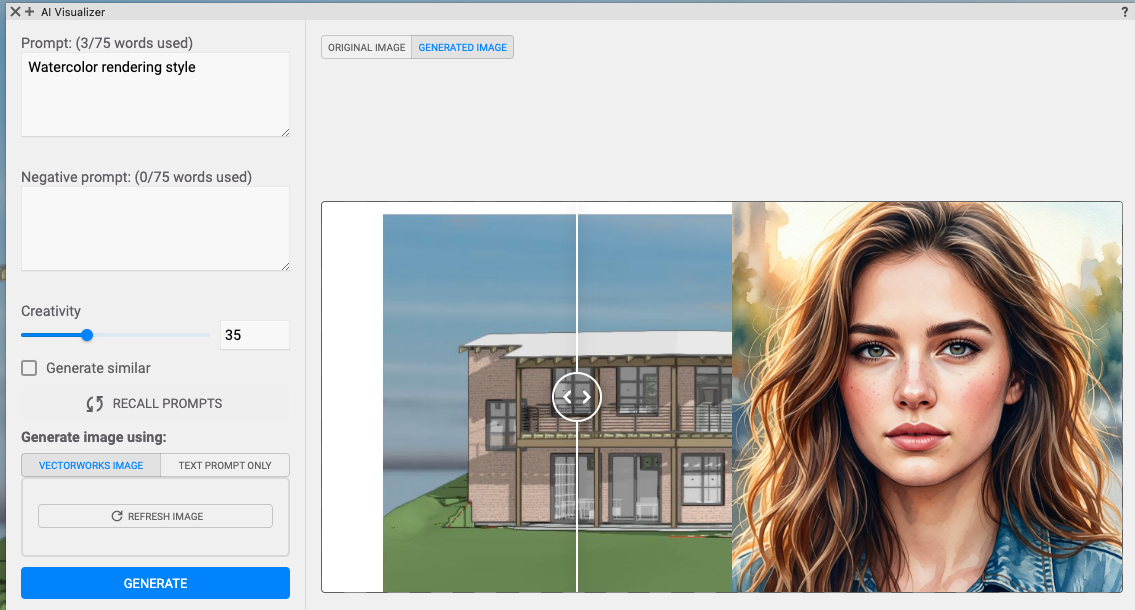

Phil Schawe Posted Friday at 10:41 PM Author Share Posted Friday at 10:41 PM Just now, Pat Stanford said: You are supposed to be able to drag the separator across to see both images at the same time. Did you accidentally get it dragged to the middle? No, its two completely unrelated images: one unchanged from my source, and the other based solely on text prompts Quote Link to comment

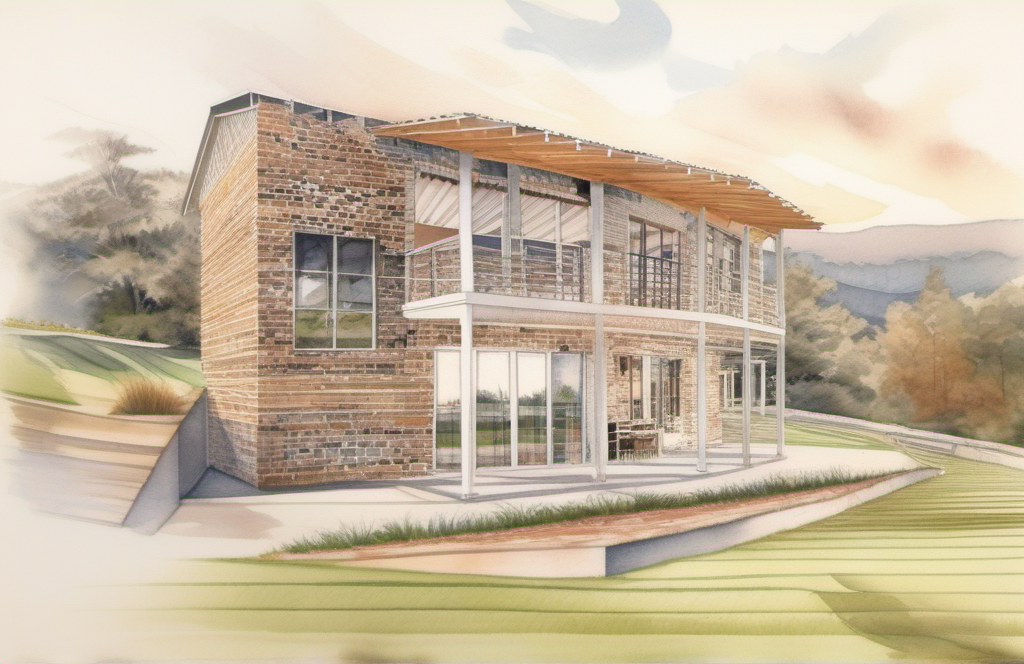

Phil Schawe Posted Friday at 10:56 PM Author Share Posted Friday at 10:56 PM 8 minutes ago, Pat Stanford said: Restart VW. Thanks pat. First thing I tried. Also computer restart, Same results - weird I had previously got this rendering below; just trying to update & tweak it. Quote Link to comment
Pat Stanford Posted Friday at 11:07 PM Share Posted Friday at 11:07 PM It appears the visualizer is hung. I can't get any image, just the spinning Queued notification. I have tried to report this to VW. Quote Link to comment
Pat Stanford Posted Saturday at 04:51 AM Share Posted Saturday at 04:51 AM Try right clicking on the Generate button and choose Reload this Page. It has been suggested that that can kick start the Visualizer. It worked for me a few minutes ago. Quote Link to comment
