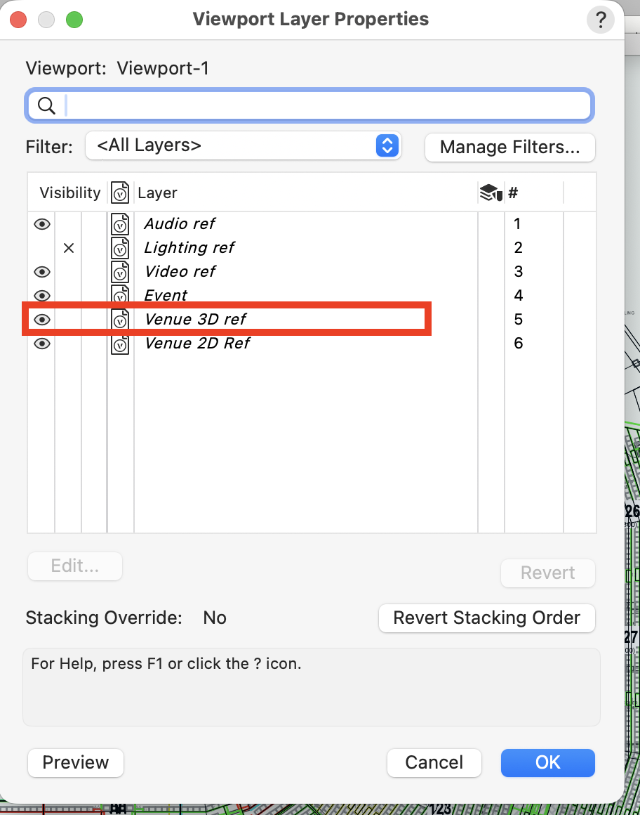

Vectorworks, Inc Employee Peter Neufeld. Posted March 4 Vectorworks, Inc Employee Share Posted March 4 Hi Mickey, I think it'll be a memory issue rather than a Mac/PC thing. I rebuilt the file using layer import that prohibits any design layer viewports (DLVP) from coming across. It made the file 45MB compared to 137MB and when reffed into a new blank document it was instantaneous. Therefore the DLVP on the Master Ref layer is the culprit. If you make invisible the the Venue 3D ref layer save the master file and re-reference it back into the lighting file it'll be instantaneous too. Cheers, Peter Quote Link to comment
Mickey Posted March 5 Author Share Posted March 5 On 3/3/2026 at 8:54 PM, Peter Neufeld. said: Hi Mickey, I think it'll be a memory issue rather than a Mac/PC thing. I rebuilt the file using layer import that prohibits any design layer viewports (DLVP) from coming across. It made the file 45MB compared to 137MB and when reffed into a new blank document it was instantaneous. Therefore the DLVP on the Master Ref layer is the culprit. If you make invisible the the Venue 3D ref layer save the master file and re-reference it back into the lighting file it'll be instantaneous too. Cheers, Peter Steven Shorter has been helping me with this as well and we came to the same conclusion. Can you explain why DLVP is doing this? I can't do Layer import as that brings the data into the file. One of the points of doing a reference is the venue files are not available to the public. I need to keep those on a local drive, and not the dropbox. Viewports protect the IP. If it's layer import, and you delete the reference the geometry is imported into the working file. To make this better a friend suggested trying to export everything to 2025 Low and behold that works fine so we've moved all vendors, and users to 2025 for this project. Why does it work correctly in 2025 but not in 2026? Same project different issue all of a sudden nobody on Mac's could open files I recently edited. I sent files to several people to test, and the Mac's could not open, but PC's could. VWX26 is not a good product. Quote Link to comment
