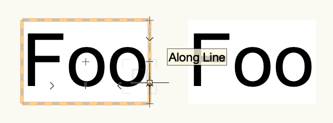

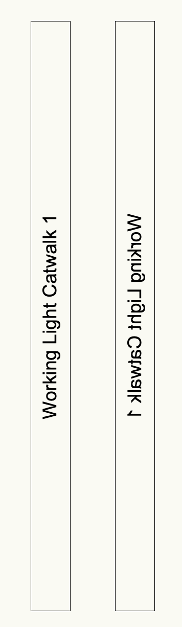

fips Posted February 20 Share Posted February 20 (edited) Using the mirror tool with connectcad equipment produces a mirrored / unreadable font. with standard text this is is no issue: On vw 2026 update 3.1 macos. Edited February 20 by fips 2 Quote Link to comment
Vectorworks, Inc Employee Conrad Preen Posted February 24 Vectorworks, Inc Employee Share Posted February 24 @fips yes this is true of any 3D object containing text. And here's something to think about, in general if you mirror a 3D object, it is no longer the same object. If it was a left-handed object the mirrored object would be right-handed. So using the mirror tool in these cases is relying on the object having symmetry about the axis of reflection. I don't think this will be possible to resolve in the way you want. Conrad Quote Link to comment
