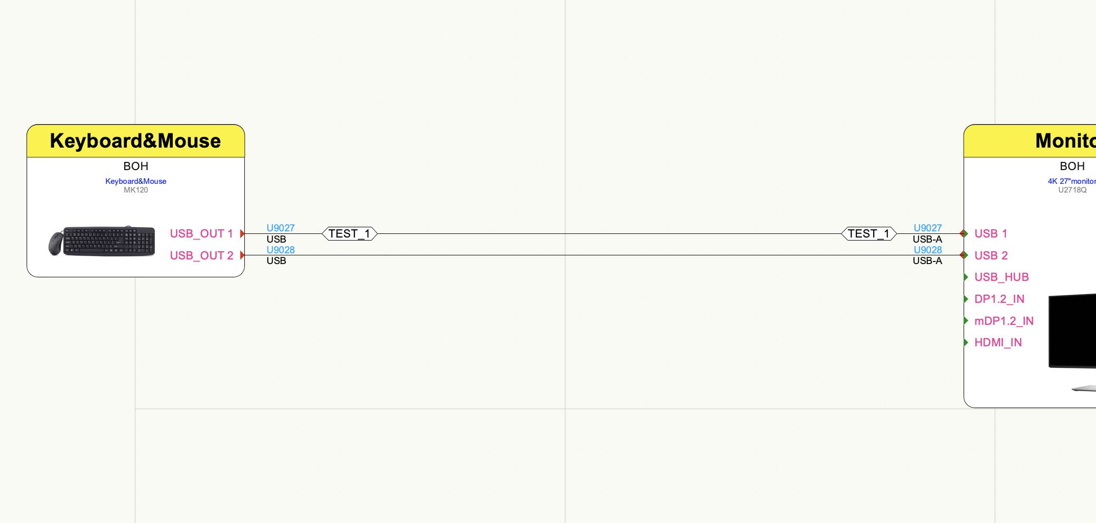

leiing Posted February 5 Share Posted February 5 Hi, do anyone know Is possible show the bubble two side of Circuit? we usual draw the matrix, it have many cable, we want to show the cable name in destination side and source device side , then it is easy to understand in pdf thanks Quote Link to comment

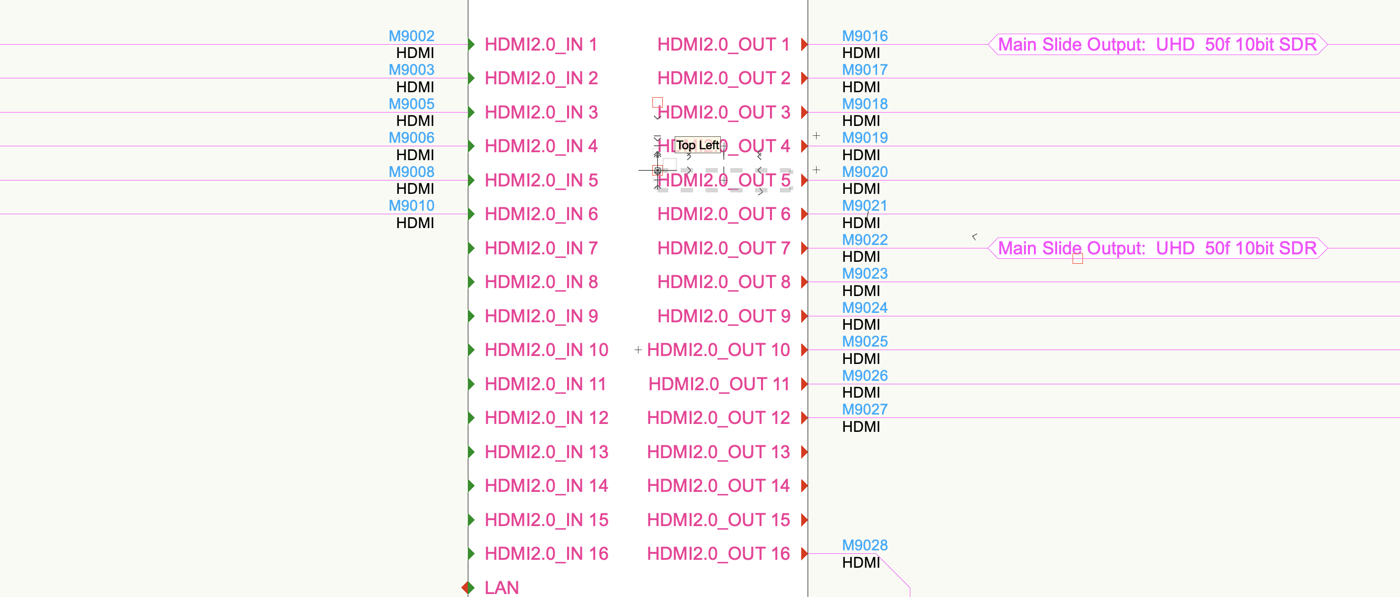

leiing Posted February 5 Author Share Posted February 5 Like this one , but i made it in photoshop , how can i make it in conectcad? thanks Quote Link to comment
spettitt Posted February 5 Share Posted February 5 Make a data tag that looks identical and then you can have as many as you want. Use a data vis to make it change colour if you want it to follow the circuit colour. That's what we do. 2 Quote Link to comment
