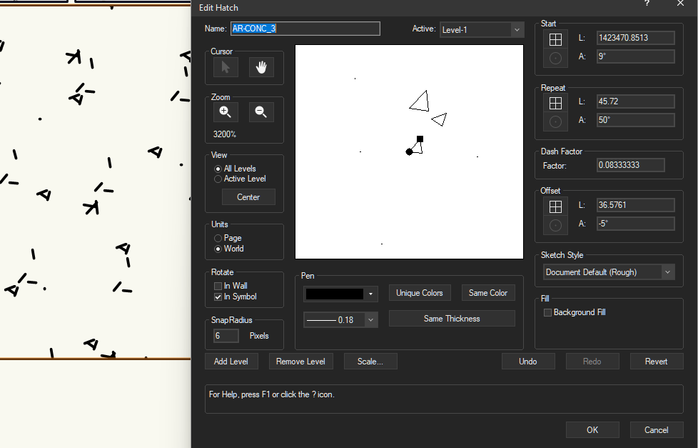

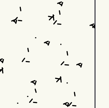

DSmith2300 Posted February 3 Share Posted February 3 Hi all, Long running curiosity not specific to any particular VW version. Why are some hatches borked in actual use, when the editor view (and thumbnail) looks OK. Any way to fix them? Quote Link to comment
shorter Posted February 4 Share Posted February 4 It's because of the coordinates of the hatch. The further from 0,0 you start the worse it gets. This didn't come from autocad did it, by any chance? Quote Link to comment
DSmith2300 Posted February 10 Author Share Posted February 10 Mmmm... possibly. Unsure. I'll look out for that in the future. Shouldn't make a difference though, in the ideal build of VW. Thanks Quote Link to comment
DSmith2300 Posted February 10 Author Share Posted February 10 Quote It's because of the coordinates of the hatch. The further from 0,0 you start the worse it gets. This didn't come from autocad did it, by any chance? Curious. Thanks. Nope, a native VW hatch. Quote Link to comment
