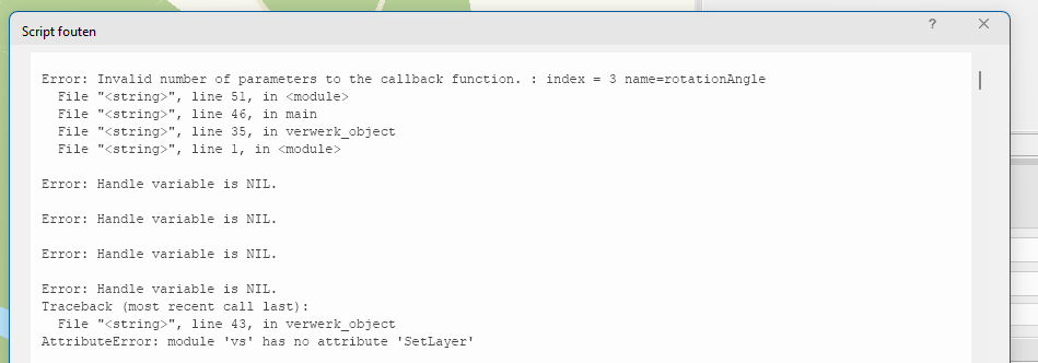

Hello fellow forum users,
With a lot of help from ChatGPT, i have 'made' this script. My programming knowledge is not zero but it is very limited. So far this script does exactly what i would like it to do. Although when running the script, I get the error message in the image. No suprise Chatgpt or Copilot have no clue why it is happening.
What is going wrong?

Hello,
ChatGPT and other LLMs sometimes use vs. Functions that dont exist.
For example vs.SetLayer to my knowledge does Not exist. Use vs.SetParent instead. (Second Error)
The other Error is in the use of vs.Symbol. this function needs the name, the insertion coordinates an the insertion angle. You dont provide the angle.
Please search for the functions in the vwx function reference for more information.
