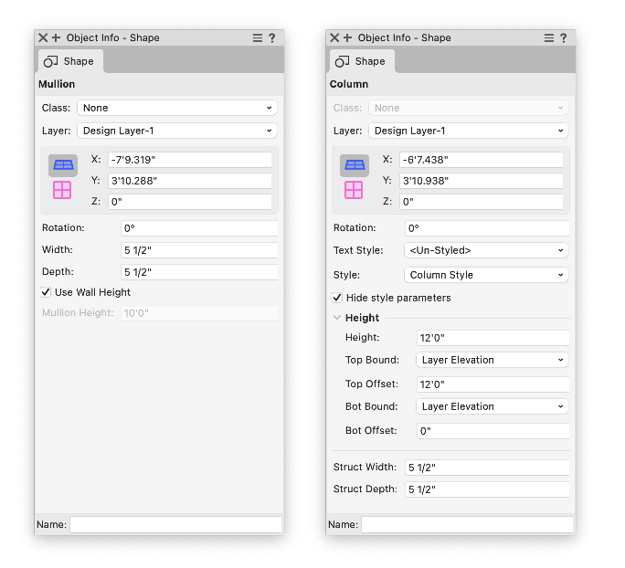

0 Tom W. Posted February 3 Share Posted February 3 I'm not sure what 'merging' the Floor command + Slab tool would look like. Surely it's just a matter of getting rid of the Floor command...? But then people will say 'but I use Floors all the time!' + we're back to square one again... It's the same as Mullions + Columns. I don't use Floors but I can see why people would want a really simple way to create a hybrid object. Again, I can just remove it from my workspace if I don't want to see it. Quote Link to comment

0 cberg Posted February 3 Share Posted February 3 Part of the reason I use these legacy tools is that 3d solids do not support 2d fills. There is no way to convert solids into parametric objects, which is a huge problem in VW. And there is a clarity and simplicity to these tools that vanish when you try to make these tools do everything else BIM needs to do. If VW created a pathway from solids modeling to BIM, we could retire these problematic (from a development perspective), antiquated workflows. 2 Quote Link to comment
