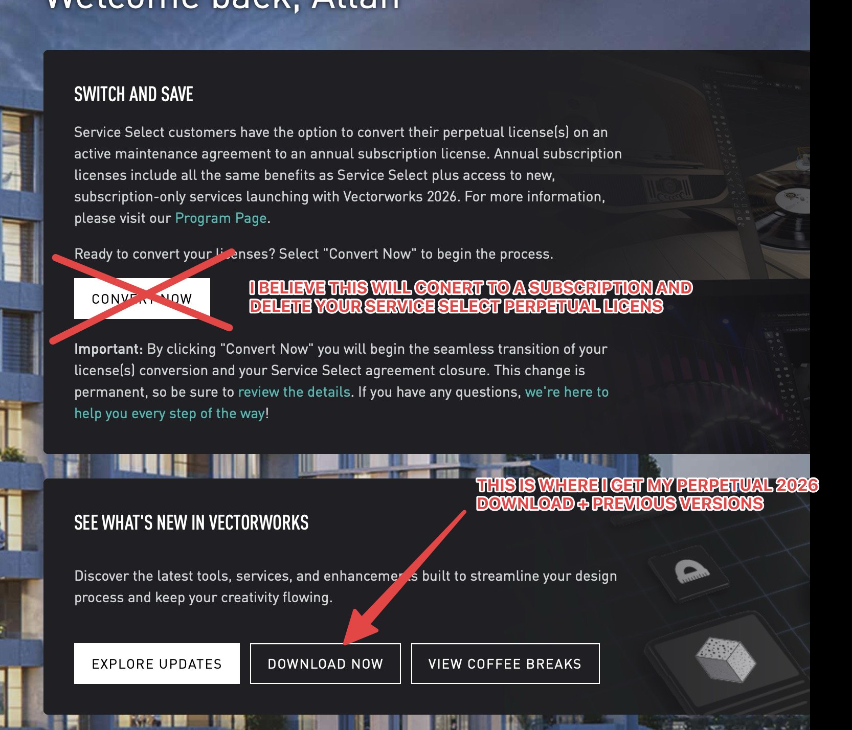

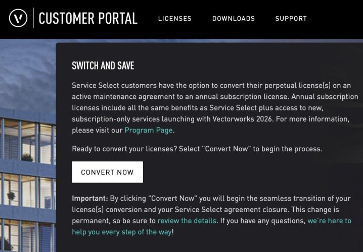

E|FA Posted December 12, 2025 Share Posted December 12, 2025 (edited) When you log in to your Service Select account (https://customers.vectorworks.net/dashboard) does it show that your account is active? If so, you should be able to download a 2026 perpetual license and ignore the Convert Now message at the top of the page. The message seems to imply that a single click will permanently remove you from Service Select, so don't do it. They're really aggressive about pushing Service Select subscribers to convert the licenses. Edited December 12, 2025 by E|FA 1 1 Quote Link to comment

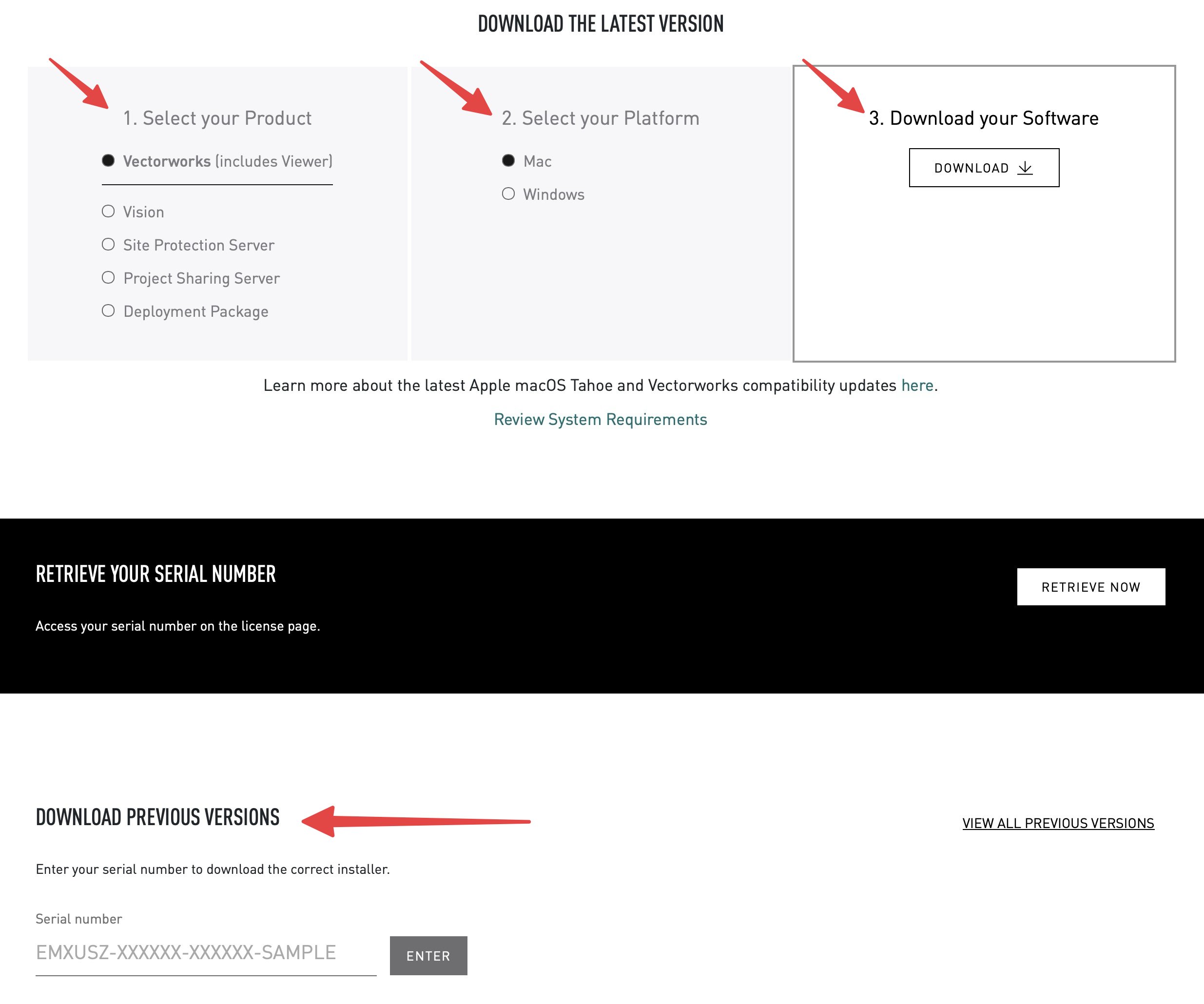

Popular Post E|FA Posted January 7 Popular Post Share Posted January 7 Don't click on the Switch & Save "Covert Now" button. I'm pretty sure that will convert your Service Select "perpetual" license into a subscription. Instead, use the "Download Now" button below (see attached screenshots) that will take you to a download screen for VW 2026 as well as previous versions that you may have access to (based on when you started Service Select). I understand your concern - and unless a VW employee happens to respond to this thread, you might want to call customer service or your sales rep (if you get marketing emails from them like I do) to be 100% sure. 4 hours ago, beanus said: Are there many improvements from 2025 to 2026? Yes, but... Walls are handled differently, so you'll need to take time to change settings, Styles, Viewports, etc, There are numerous threads on the forum dealing with the issue. There are a few ongoing bugs that have affected people (search the forum). My advice is not to switch any active projects to a new version. I have both VW 2024 & 2026 installed on my Mac. I am still working with VW 2024 as my primary version, while testing and setting up VW 2026 for upcoming new work. https://app-help.vectorworks.net/2026/eng/VW2026_Guide/LandingPage/New_features.htm https://www.youtube.com/watch?v=CWJUEJEkRNk 5 Quote Link to comment
