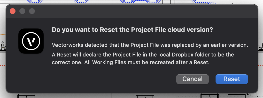

DCarpenter Posted December 1, 2025 Share Posted December 1, 2025 Our company has used Project Sharing files for many years. We are very familiar with the do's and don't of working with PF's, but for some reason, for the past 3 months we've experienced the "Do you want to Reset the Project File cloud version?" box popping up a lot. Usually we'd only see this if a vendor moved the PF off or around Dropbox. Just today, I told a coworker we needed to make this VWX file a PF, and he agreed. I created it, with a Sharing Method of 'Cloud service', since we are storing the PF on Dropbox. He and I are both admin's. 2 hours later I get the 'Do you want to Reset...' pop-up box on my first attempt of doing a Save and Commit. * We are working on, and saving Working Files to our desktops, not on Dropbox. * We are not moving the PF off or from where it sits on Dropbox. * We are all working on the latest version of Dropbox. * The PF on my local computer was available offline, and not just referencing the online file. * We are all working on Vectorworks 2025. Is there something I'm missing to help me understand why we're getting the "Do you want to Reset the Project File cloud version?" pop-up on a regular basis? Dave Quote Link to comment
DCarpenter Posted December 2, 2025 Author Share Posted December 2, 2025 So I'm not sure if I found the problem or just figured out a work around but we were able to have a problem free experience with our Project File when we posted it on one of our employee's person Dropbox account. The only difference being, our company recently upgraded to an Enterprise Dropbox account, and our employee just has a standard Dropbox account. I'm looking into this further but there might be some sort of security thing that Enterprise is doing that's causing Vectorworks to think the PF needs to be reset. Stay tune to this bat channel for more news. Dave 1 Quote Link to comment

DCarpenter Posted January 9 Author Share Posted January 9 It's good to know I'm not the only one with this issue. Small update for me. Moving our PF to a Project Managers private Dropbox account didn't make our problem any better, so we're still left to wonder what the problem is, and it's getting to a point of frustration for the team. Some people are suggesting getting rid of the PF and just referencing a master VWX file. That can work but it's messy. I called VW tech support and I was told I would need to have the PF on the VW Cloud Server in order for their technicians to look at the metadata to see what's going on. We haven't done that yet, but the more I thought about it, I thought, isn't the metadata is part of the VWXP file? Dave 1 Quote Link to comment

DCarpenter Posted January 23 Author Share Posted January 23 @Christiaan Thank you for jumping into this thread. Any suggestions as to why my company is receiving some may "Reset Project File" windows popping up? We've tried two different Dropbox accounts, we've been using PF's for a number of years. I've never seen so many "Reset Project Files" windows pop up, as I have in the last 6 months. In the last two days, my partner and I have had 4-6 Reset widows pop up so far. This has been happening on at least two PF's that I'm aware of. I'm out of ideas, any suggestions on what I should I do? Dave Quote Link to comment
Christiaan Posted January 24 Share Posted January 24 I'm not sure Dave. I've had a couple of terrible experiences with Dropbox speeds recently, which can lead to issues with PS. Or perhaps it's particular change to one of Vectorworks' updates? But I would definitely give Vectorworks Clouds Services a go. Either you'll still have the problem and VW can take a closer look at it, or the problem will go away. Quote Link to comment
