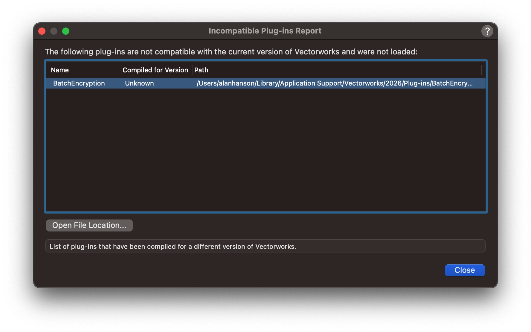

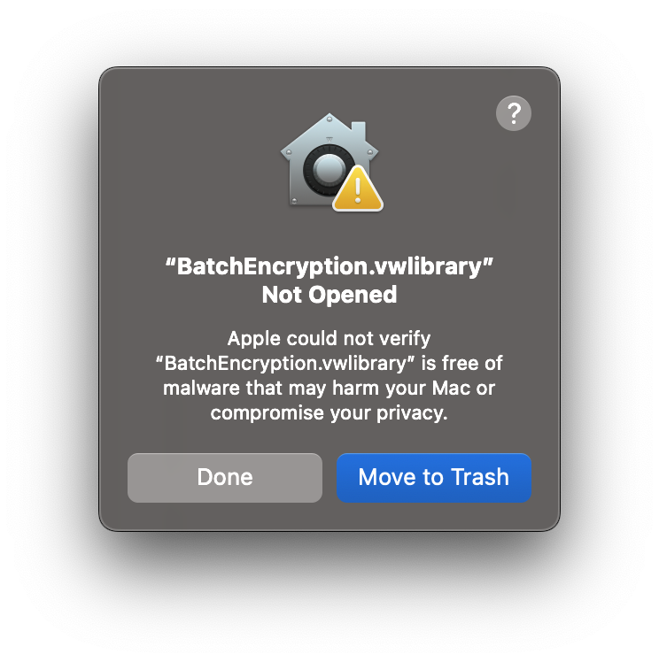

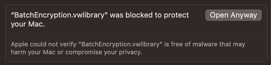

AlHanson Posted Sunday at 04:17 AM Share Posted Sunday at 04:17 AM Piggybacking on this as I'm struggling with this process in 2026 as well. •I've downloaded the current SDK for 2026 from https://www.vectorworks.net/en-US/support/custom/sdk/sdkdown •I've copied the BatchEncryption.vwlibrary file into my plugins folder but when launching Vectorworks I get two separate errors: •The first is a system Security alert that tells me it can't open this file because it cannot be verified. •The second is from Vectorworks and it tells me that the BatchEncryption is not compatible with the current version •Trying to run anything that uses EncryptPlugins will fail because this is not loading •I've tried going into the Privacy & Security System Settings and it does show the BatchEncryption.vwlibrary file as something that the system is preventing from loading, but clicking the Open Anyway button doesnt do anything (This is normally for application so I assume this behaviour is normal in this case) Anybody else experiencing this and found the solution? Quote Link to comment
Jesse Cogswell Posted Sunday at 04:22 PM Share Posted Sunday at 04:22 PM (edited) I recently bought a Mac strictly for plug-in testing purposes. I was able to find a workaround for this annoying "feature". In terminal, type: xattr -d com.apple.quarantine <path to .vwlibrary file> For the path, I just did a click and drag of the BatchEncryption.vwlibrary file in Finder to the Terminal directly. Edited Sunday at 04:24 PM by Jesse Cogswell 1 Quote Link to comment
AlHanson Posted Sunday at 10:16 PM Share Posted Sunday at 10:16 PM Amazing! That solved it. Thank you much! Quote Link to comment
