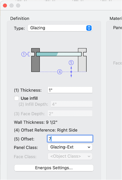

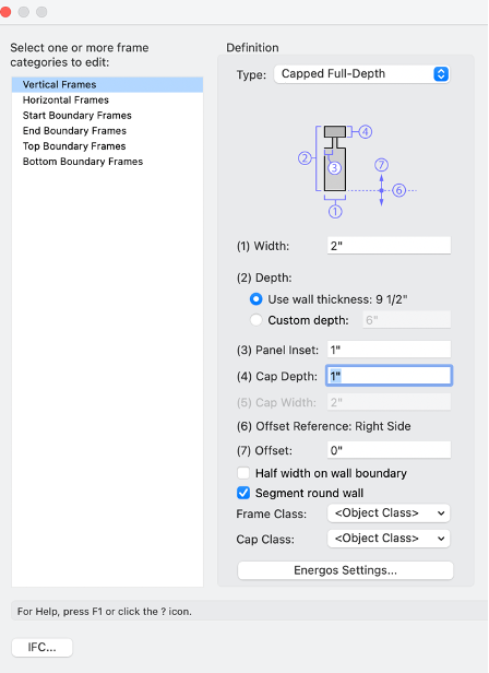

a. Glass inset is given from the face, not the back – setting 5
b. The glass inset should be set by the cap depth – that channel is where the glass sits – the way to tool is set up is prone to error, because both cap depth and glass inset have to be set manually to match, and the tool is set up with cap inset and glass offset in opposite directions–
