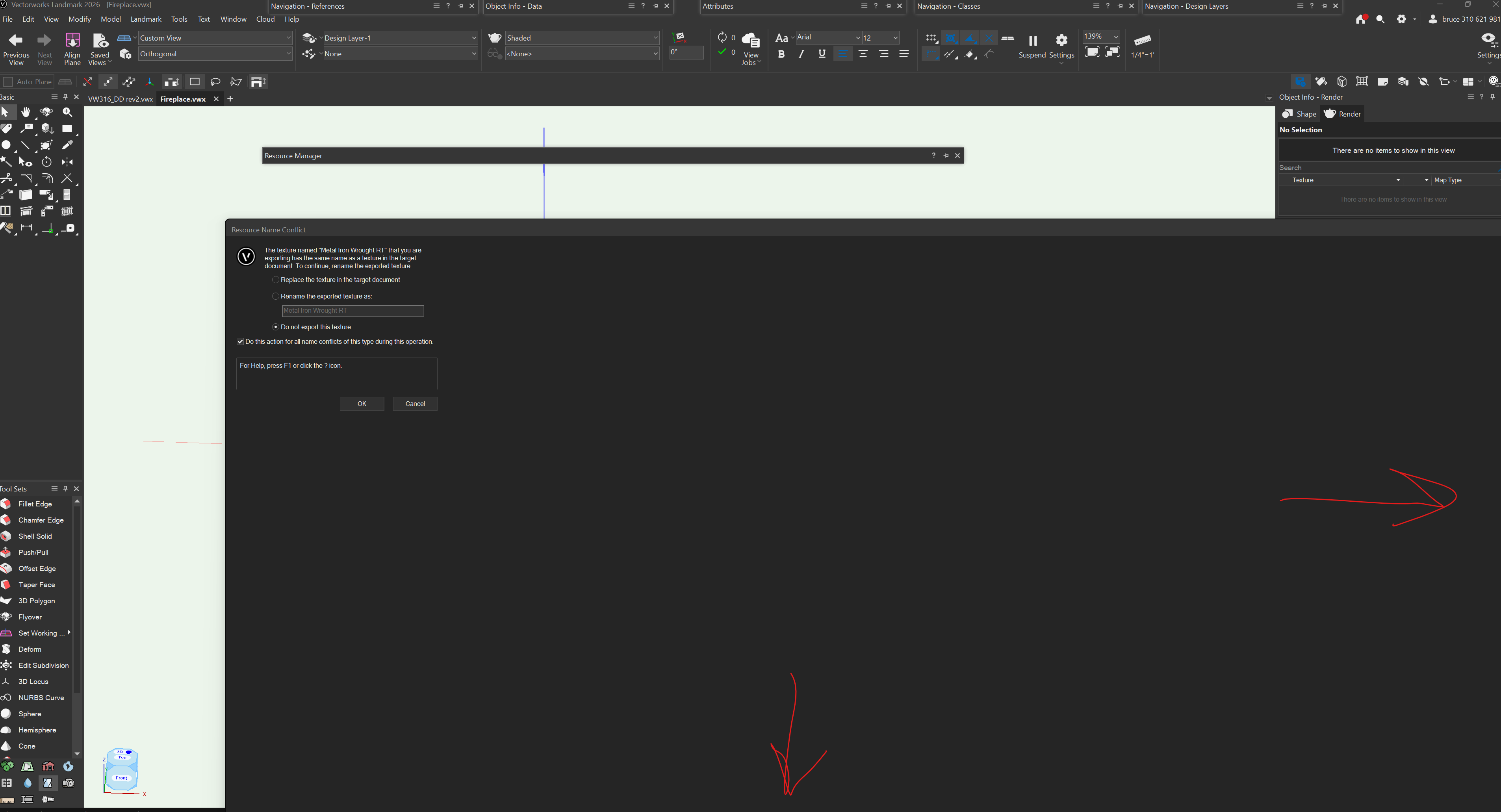

Every time I get a warning menu the size of the popup increases.
Once they are larger than the screen size, I can't reduce them and they just keep getting larger ...and then all of a sudden, for no apparent reason they pop back to the normal size.
This isn't a workflow issue as the relevant areas are in the upper left-hand corner and are always accessible - but I thought it might be a bug
Here is the resource name conflict warning - taller than my screen and almost the width of my second monitor.

Try resetting your user saved settings. Tools>Options>Vectorworks Preferences>Session>Reset Saved Settings
I'm going to guess that you are using Windows on a high DPI monitor with the scale set to something other than 100%.
We have had a few reports of various dialogs growing in size growing in size because of the scale setting especially with multiple monitors of different resolution.
I think after a certain point the overall dialog becomes larger then the screen and gets reset the the default size.

@klinzey I do have two monitors, a laptop and a second monitor.
Laptop scale is set to 250% (the "recommended" setting)
Second Monitor scale is set to 150% (also the recommended setting)
Both are at their recommended resolution.
And yes, after growing each time, they do eventually reset to default.
@Pat Stanford
Video driver did need to be updated as of Oct 15th - I've done this and will check back in if that fixes the issue.
I do not have this issue with 2025
