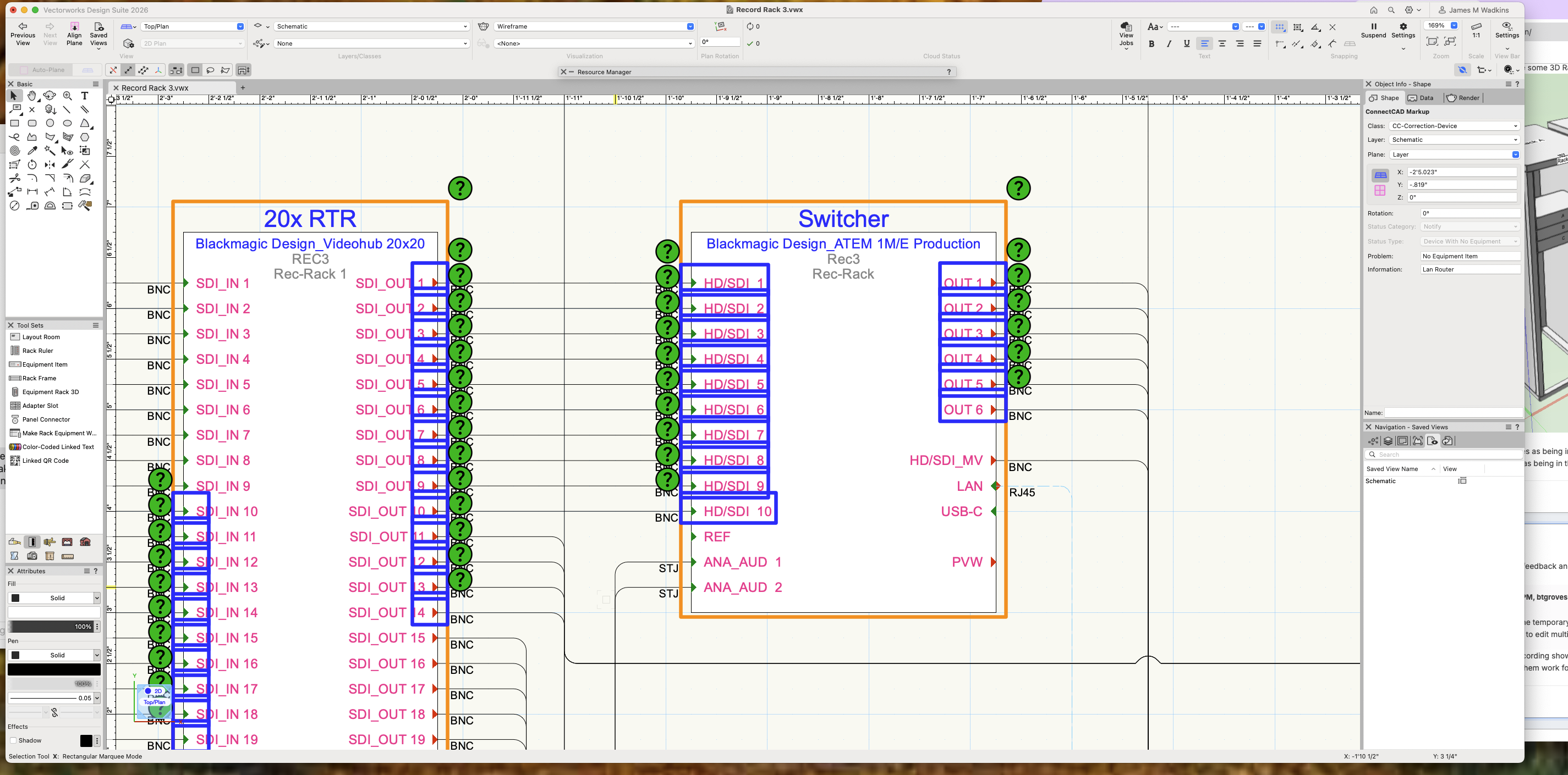

I am using VW CC 2026 Update 1 (build 835767) on a Mac MBP M4 maxed out. I am still very new to CC so there is that. I did use the ConncetCad Imperial templet for this project.
When I drop equipment into a drawing from the Device Builder or Device and set the room and rack info, I cannot place them in the rack. The equipment items are all from the CC library except one and ALL have this issue.
Running a drawing check ALL devices show up with a green question mark bubble. The message tied to the bubble says "No Equipment Item" see pic. I tried search for an answer on the knowledge base and web in general and nothing yet (possible wrong search criteria). I have done this one before in 2024 version without issue.
Any suggestion and things to look for?
Link to comment
  • Vectorworks, Inc Employee
Hello @Vegas James,
What you see is just a notification that your schematic devices do not have physical 3D equipment items associated with them. You can simply run the Create Equipment menu command to create the needed equipment items to get rid of the notification.
You also seem to have some notifications about many sockets, if you want you can share what they are and if you need help resolving them.
Best Regards,
Nikolay Zhelyazkov
