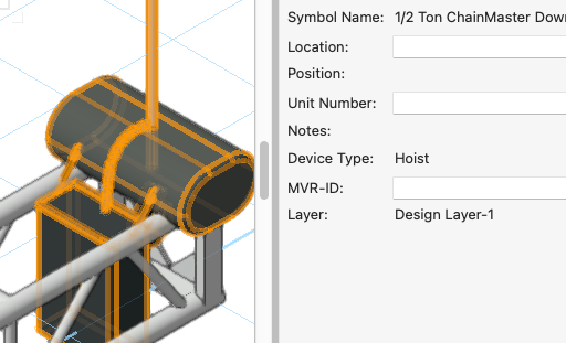

BRSebbe Posted November 3 Share Posted November 3 Is Hoist objects limited in the Data Manager in VWX2026? Im trying to learn how to do some automatic mapping and making custom datasheets, showing only the information i need. Very new to using the Data Manager at all, so any tip is welcome! Cheers Using "parametric object - Hoist" Gives everything, but mappings and conditions are greyed out. Creating a criteria based mapping, finds 3 objects in the criteria dialog, but nothing in the data sets window Quote Link to comment

BRSebbe Posted November 4 Author Share Posted November 4 3 hours ago, Scott C. Parker said: Can you provide more details on what these custom datasheets should show? Are you thinking of worksheets and databases? What information are you trying to pull from the hoists? Please post a sample file so that the collective can take a look. I've not gotten so far as to actually have anything in a file that is not already in a blank document. This is a blank document with 3 hoist objects put in, nothing else. I would love to map the "function" field to fill based on what layer it is on for example, but im just trying to get started somewhere. Im mostly curious as to why "parametric object - hoist" fields are not definable nor mappable, and why criteria based ((PON='BrxHoist')) says no objects found, when it actually does find objects when editing the criteria! I've found that there isnt really much information regarding WHAT you can do with the tool, as in different use cases, or maybe im just bad at looking. Quote Link to comment

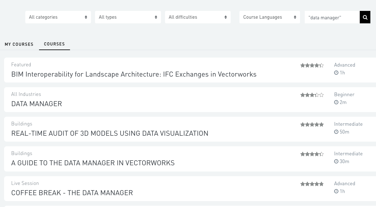

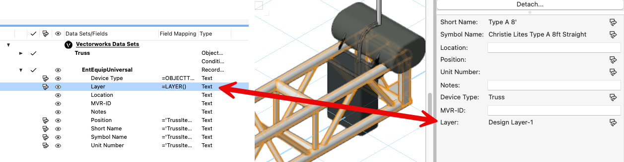

Vectorworks, Inc Employee Scott C. Parker Posted November 4 Vectorworks, Inc Employee Share Posted November 4 The data manager can map most data -from- the oip of objects, but not -into- the fields in the oip. A good example of how we use the data manager for spotlight objects is the EntEquipUniversal record we attach to most Spotlight objects during insertion. We've mapped several fields to pull info from the device's OIP and insert this into the EEU record. You can make changes to the OIP, and the EEU is updated. However, you also have the option to change the EEU from By Style to By Instance and then can edit the info in the EEU without changing the info in the object's OIP. As for your Layer need, I've edited my EEU to add a layer field. I've then added the layer to the same record for Truss via my data manager, and it reports the layer of the truss. Moving the truss to a new layer updates this field, but editing it does not move the truss. 14 hours ago, BRSebbe said: I've found that there isnt really much information regarding WHAT you can do with the tool Have you explored the offerings in the VW University? 1 Quote Link to comment

BRSebbe Posted November 4 Author Share Posted November 4 Thanks for the resources, will definetly comb through this! Quote Link to comment
BRSebbe Posted November 4 Author Share Posted November 4 5 hours ago, Scott C. Parker said: The data manager can map most data -from- the oip of objects, but not -into- the fields in the oip. A good example of how we use the data manager for spotlight objects is the EntEquipUniversal record we attach to most Spotlight objects during insertion. We've mapped several fields to pull info from the device's OIP and insert this into the EEU record. You can make changes to the OIP, and the EEU is updated. However, you also have the option to change the EEU from By Style to By Instance and then can edit the info in the EEU without changing the info in the object's OIP. As for your Layer need, I've edited my EEU to add a layer field. I've then added the layer to the same record for Truss via my data manager, and it reports the layer of the truss. Moving the truss to a new layer updates this field, but editing it does not move the truss. So, just a followup. Pushing data INTO OIPs is a hard limit? or is there SOME fields/values that can be populated by a mapping? Quote Link to comment
Vectorworks, Inc Employee Scott C. Parker Posted November 4 Vectorworks, Inc Employee Share Posted November 4 9 minutes ago, BRSebbe said: Pushing data INTO OIPs is a hard limit? I've not seen any that allow this direction. I've played with Lights, hoists, truss. I won't say it's impossible, but I've not seen it. And, when I asked the coders about writing to the OIP, it was not currently an option. Quote Link to comment
