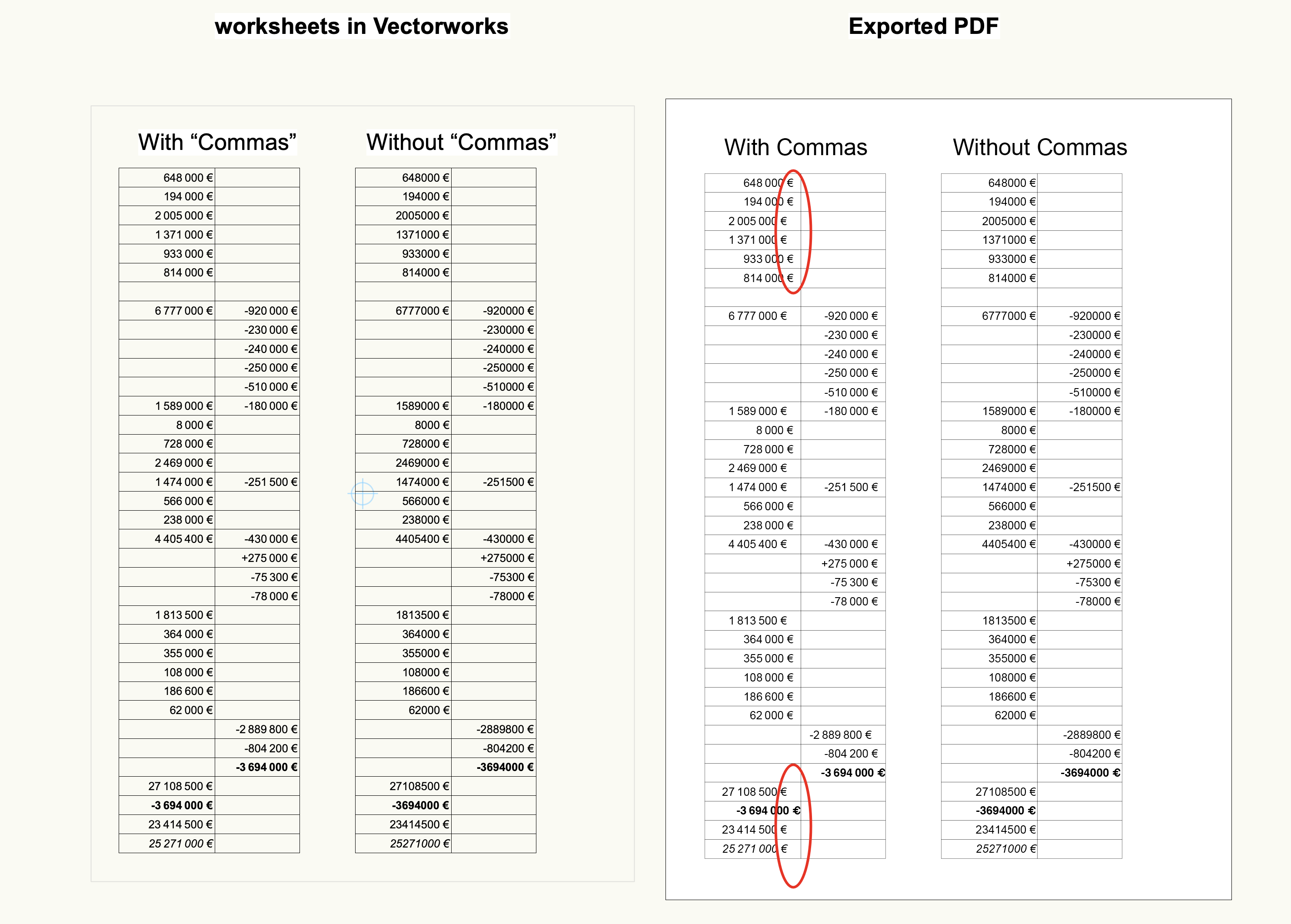

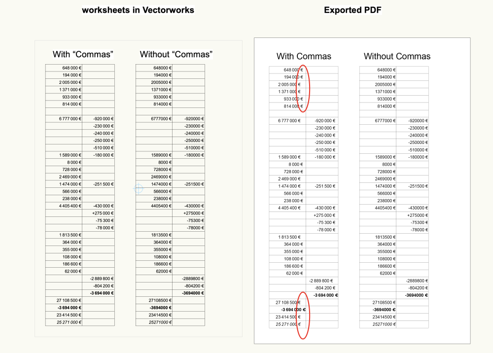

More than the previous on between what is displayed inside the worksheet environment and what is displayed in the Vectorworks drawing environment, there is another one between what is in Vectorworks and what is exported in a PDF, specifically with spaces.
Here is an example.

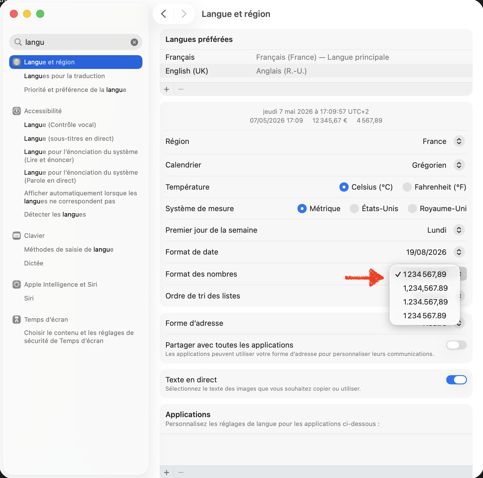

That is annoying with numbers. In France, thousands are separated with spaces. That is a system setting. I can’t customised it. (macOS).
May be it is more a bug rather than a enhancement requisition doesn’t it ?

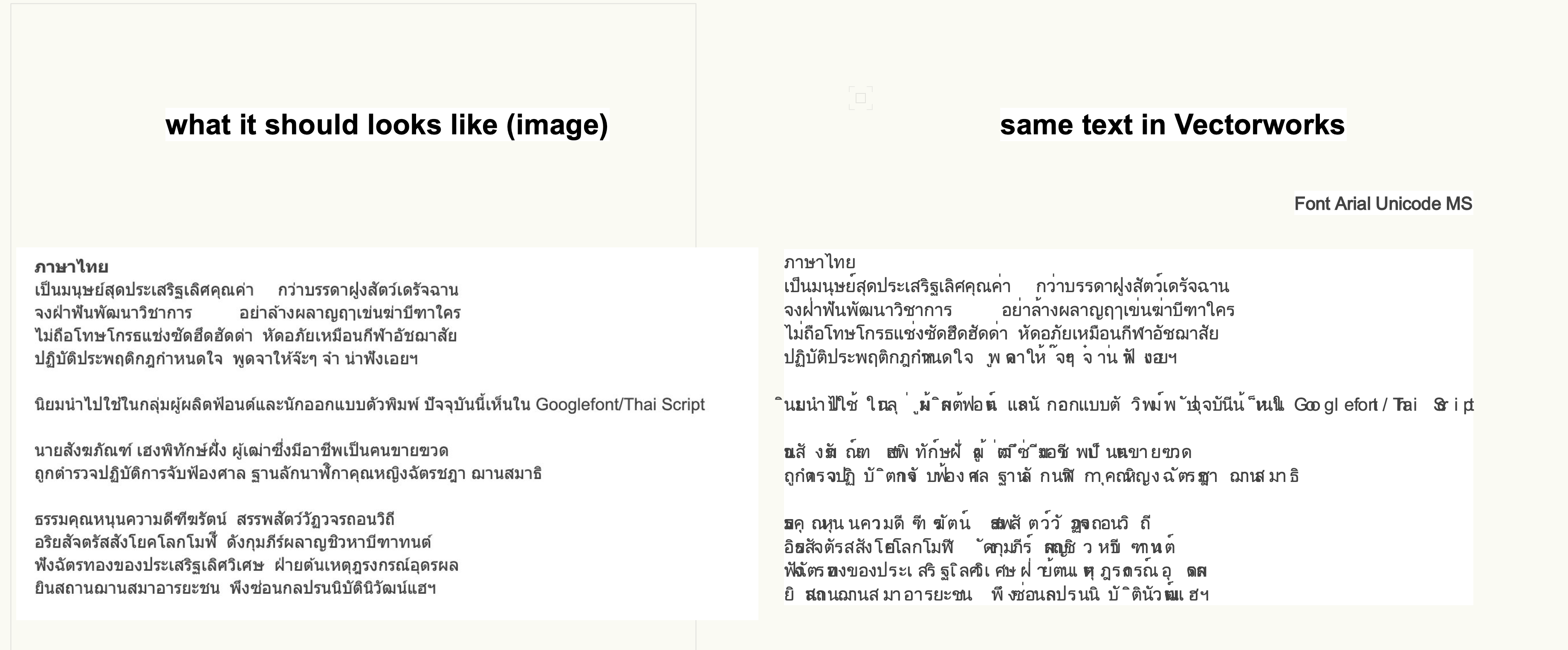

More over, I’ve got a Thai friend. Write in thai inside Vectorworks is not possible (see image attachment…), again, because of bad space management by Vectorworks…
What is possible to do ?
Vectorworks files are attached.
Here is an example.
Bug report-Spaces in Worksheets.vwx 727.95 kB · 0 downloads Bug report-Thai text.vwx 737.02 kB · 0 downloads
@Gaëtan R. go ahead and file both of these as separate issues. I am not sure Vectorworks officially supports Thai characters but it may be worth a VE. As for the number format, it looks like it should work but I'd file a bug with the sample file included. Thanks! (I exported your file using a British keyboard and it seemed to work ok. Both samples were right-aligned and looked like they were number-formatted.)

2 hours ago, Stephan Moenninghoff said:
@Gaëtan R.
Please note that it is not linked to a keyboard setting but to a system setting. Writing numbers differently that with spaces as thousands separators would be considered as an error.
Edited by Gaëtan R.
