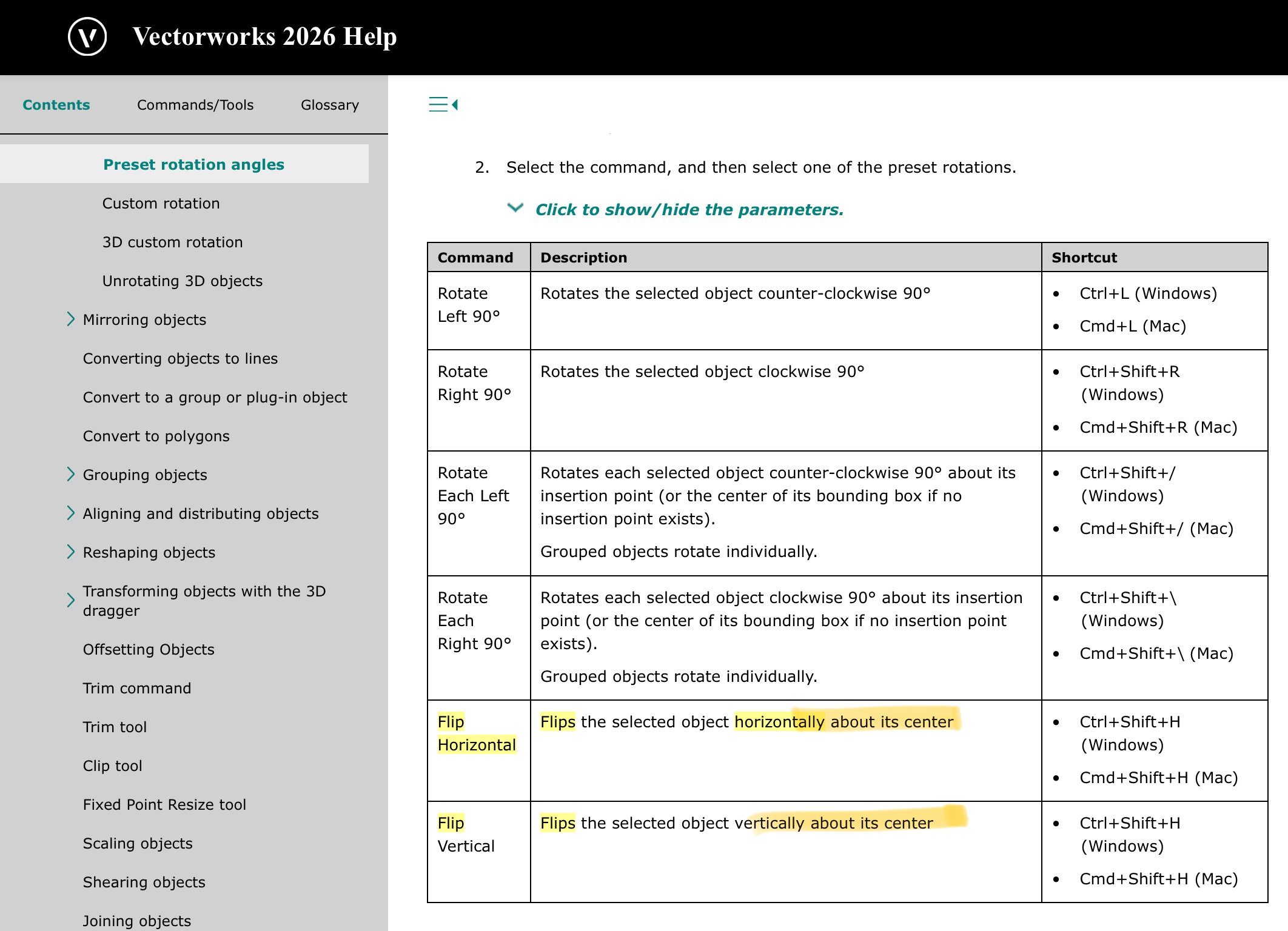

rDesign Posted October 27 Share Posted October 27 (edited) According to the Vw2026 Help file, both Flip Horizontal and Flip Vertical should both flip on its center. Edited October 27 by rDesign Quote Link to comment

Kevin McAllister Posted October 28 Share Posted October 28 22 hours ago, rDesign said: According to the Vw2026 Help file, both Flip Horizontal and Flip Vertical should both flip on its center. I've never used this keyboard shortcut before but I'm curious as to how the same short cut flips both horizontally and vertically 🤣. I think maybe the Help also needs updating. Kevin 1 Quote Link to comment
