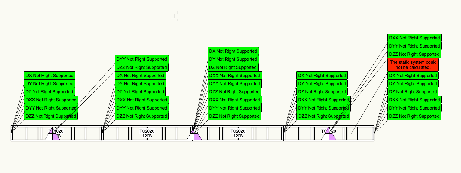

Jayme McColgan Posted September 11, 2025 Share Posted September 11, 2025 (edited) using braceworks with some 20.5" truss, and this is what I get when I run the calculation. It is happening with both Tomcat and JThomas Truss. This is in a blank new file. Edited September 11, 2025 by Jayme McColgan Quote Link to comment
Vectorworks, Inc Employee JustinVanHassel Posted September 11, 2025 Vectorworks, Inc Employee Share Posted September 11, 2025 I just tested this in VW2026 and had no issues. Are you able to post a file so the collective can take a look? Quote Link to comment
Vectorworks, Inc Employee jcogdell Posted September 15, 2025 Vectorworks, Inc Employee Share Posted September 15, 2025 These error messages mostly occure when ther Braceworks cross section data for the truss has been corrupted or lost You may need to replace the Braceworks cross sections data in the application folder Quote Link to comment
