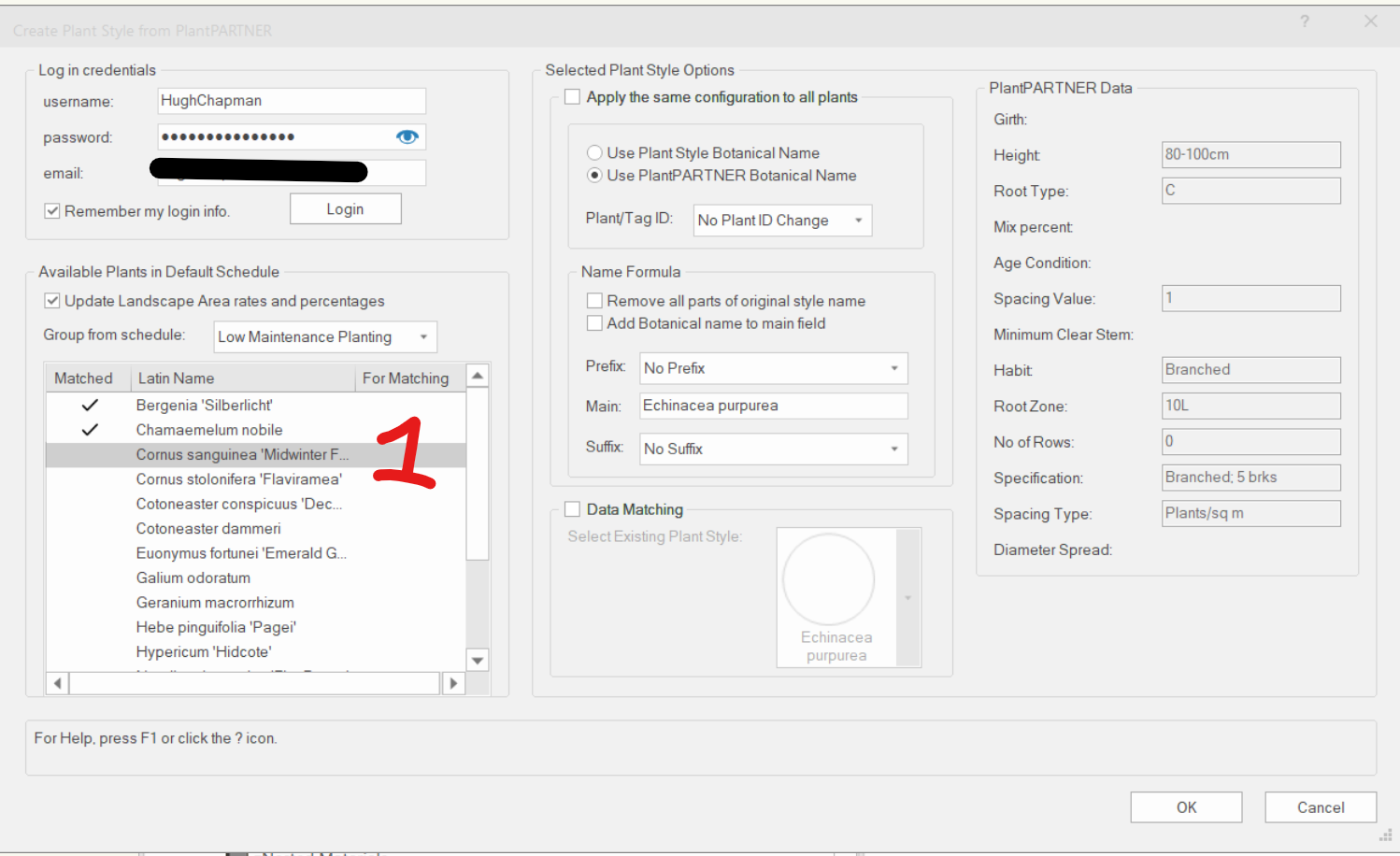

With much hacking about and a phone call to Plant Partner HQ I have found that following these steps in this order is the way to make the plug-in work reliably:
1) Select a plant species in the menu on the left. But DO NOT click in the 'For Matching' column to add a tick yet.

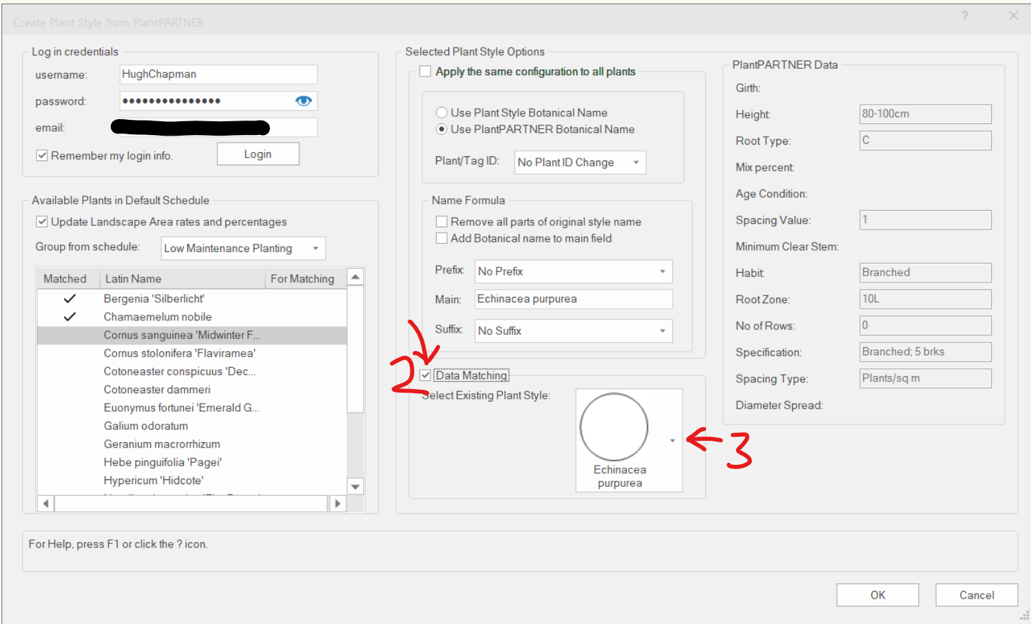

2) Unless the plug-in has found the correct PIO in the active document (it does sometimes but more often doesn't in my experience) - Click the 'Data Matching' box in the centre column to activate the option to Select Existing Plant Style via the Resource Browser.
3) Click the down arrow to access the Resource Browser

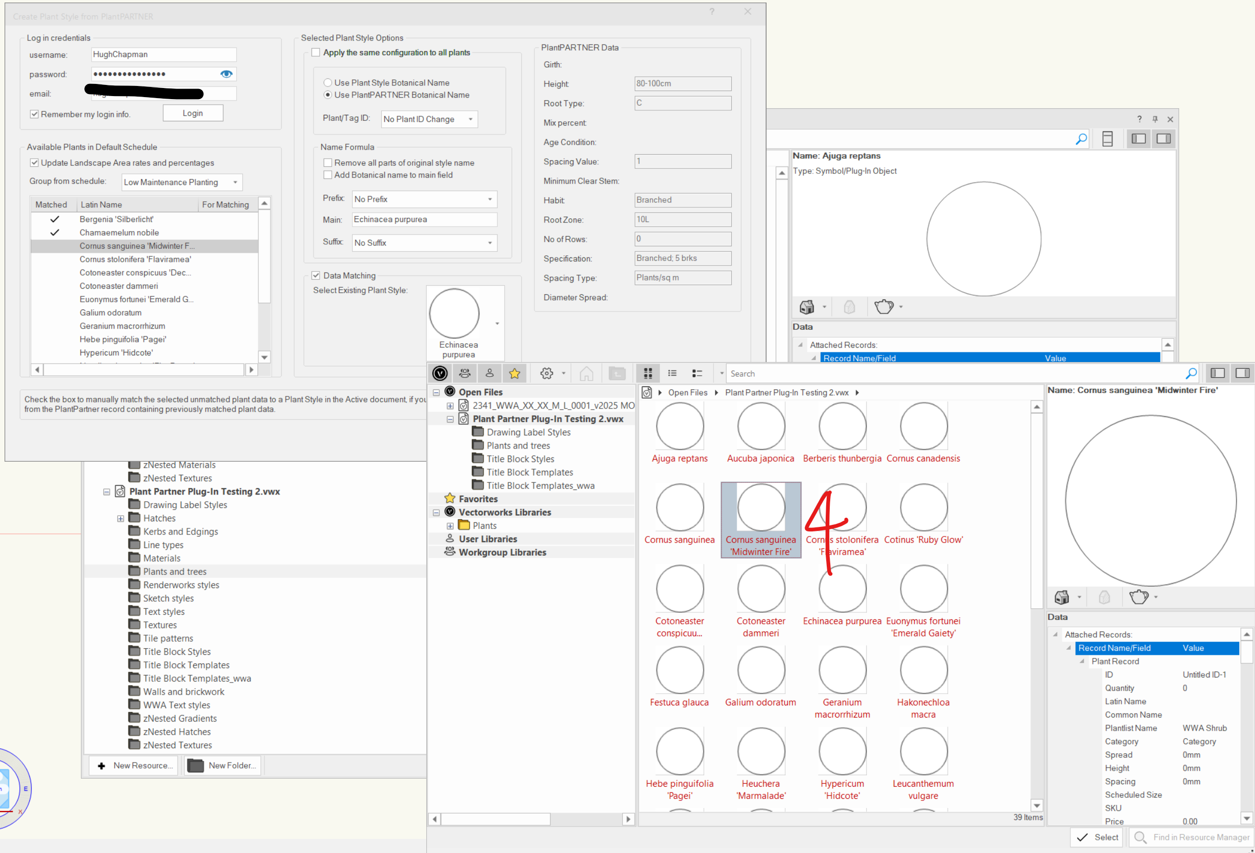

4) Select the PIO you want to link Plant Partner data to. I find it best to have PIOs named correctly in the Resource Manager but I think the plug-in can take care of re-naming PIOs via the other options in the centre 'Selected Plant Style Options' column.

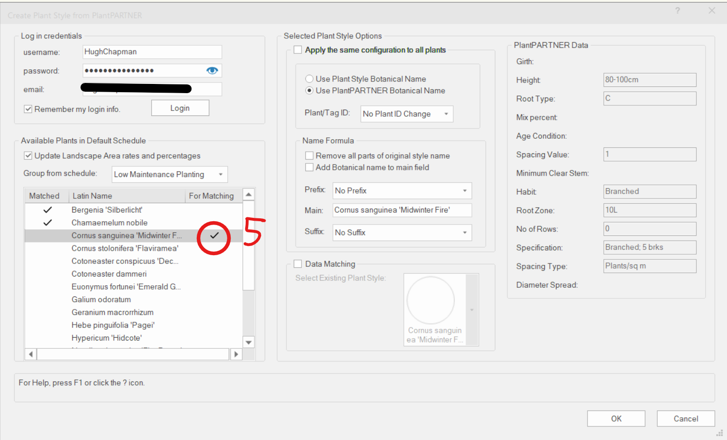

5) ONLY THEN click next to the species you want to attach the data from in the left-hand column
