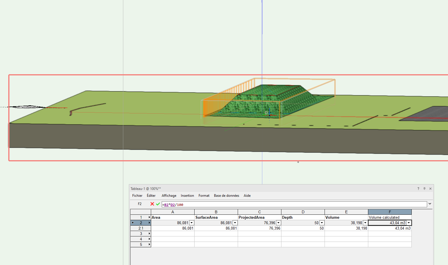

Nico_be Posted September 3, 2025 Share Posted September 3, 2025 Hello, Why don't you use a formula that multiplies the surface area by the depth of the planted surface? SurfaceArea X Depth Quote Link to comment

Nico_be Posted September 3, 2025 Share Posted September 3, 2025 Okay, I get it. The planted surface can't be configured with levels and slopes that would have an impact on the terrain. It simply follows the defined terrain. Quote Link to comment
