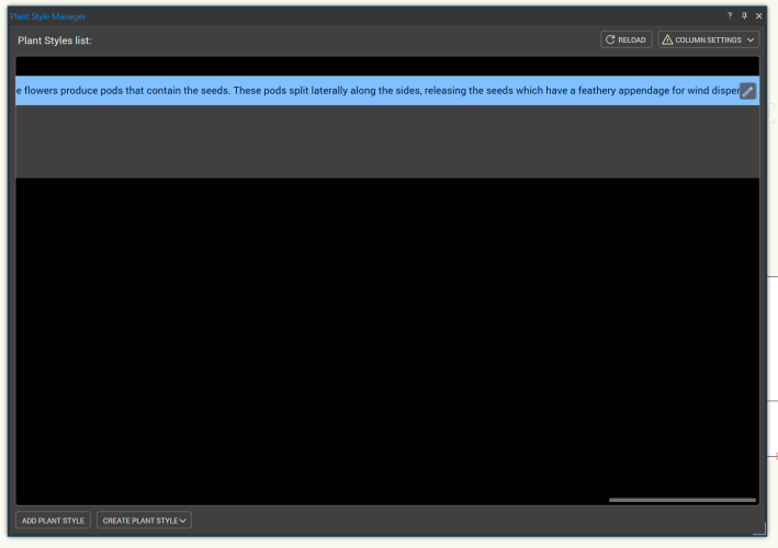

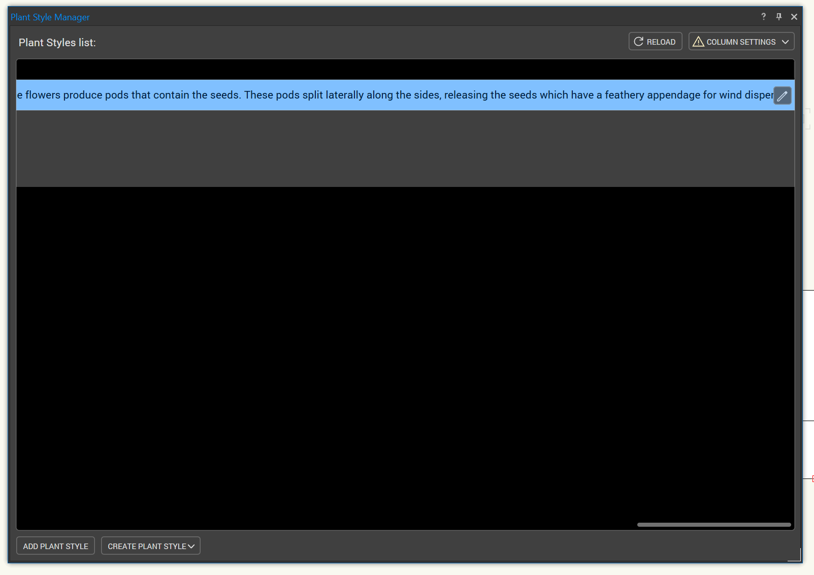

hollister design Studio Posted September 19, 2025 Share Posted September 19, 2025 @Katarina Ollikainen this is a really nice addition to the landscape design workflow! One more suggestion, the ability to 'wrap' text. We use 'comment 1' as a description of the plant and these can get pretty long. It would be nice to be able wrap the text so you could see the whole comment. ...especially since you have to scroll over to the right edge of the column to access the edit button... 2 Quote Link to comment
Vectorworks, Inc Employee Katarina Ollikainen Posted September 19, 2025 Vectorworks, Inc Employee Share Posted September 19, 2025 @hollister design Studio, that's a good idea. I'll bring it up with the engineers and see if we can implement it. 1 Quote Link to comment
