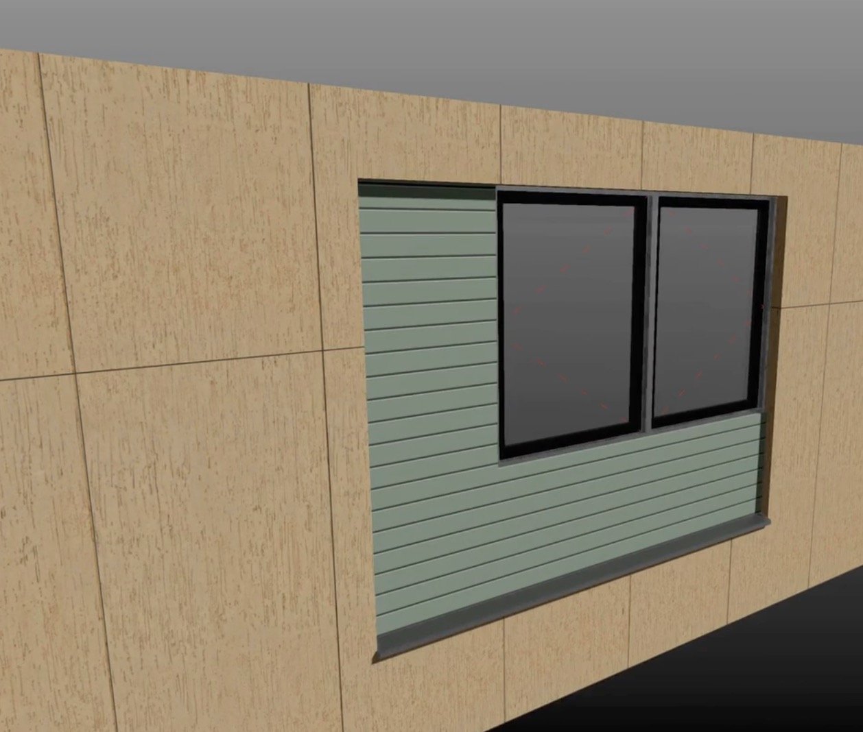

Christopher Rowe Posted August 19, 2025 Share Posted August 19, 2025 This new capability seems to eliminate the need for workarounds in cases where we want a panel between two separate windows to have a different finish than the main wall in elevation but also show up in plan as the same wall assembly. Maybe someone knows a better way to do this but we wind up just overlaying a solid object on the exterior of the wall - a pretty crude solution. This need has nothing to do with the way windows are manufactured or shipped or installed. A a nice improvement to the BIM workflow. Quote Link to comment
