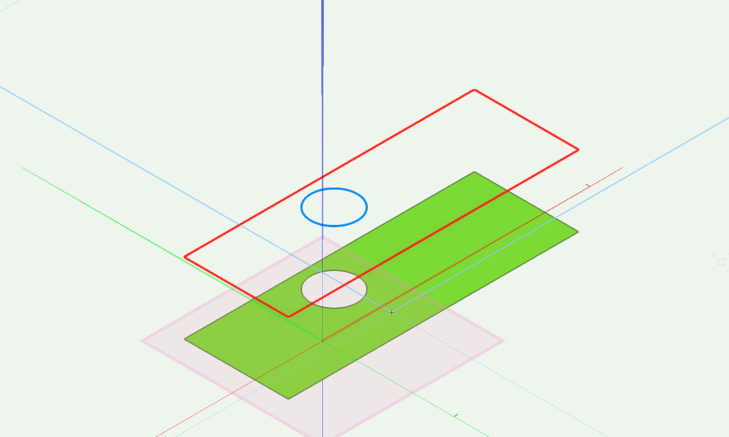

Laurentbiotopes Posted August 16, 2025 Share Posted August 16, 2025 Hello, i'm looking for a way to extract Nurbs curves from flat Nurbs surfaces with Marionette. It's also impossible without redrawing them in vectorworks. Somebody have a track for that? Quote Link to comment
the frog Posted August 19, 2025 Share Posted August 19, 2025 hello please attach the VW file Quote Link to comment
Laurentbiotopes Posted August 20, 2025 Author Share Posted August 20, 2025 Hère it is.....🙂 EXTRACT CURVES NURBS SURFACE:MARIONETTE.vwx Quote Link to comment
the frog Posted August 28, 2025 Share Posted August 28, 2025 Hello I found a strange solution to your question. It consists in naming each part of the surface by double ciick; edit volume; select the object and name it. Do the same on the sculpting one with, of course, a different name. In the marionette script in the name nodes put the object names You will get what you look for in a group. If you ungroup you’ve got your nurbs. Hope it works for you solution?EXTRACT CURVES NURBS SURFACE_MARIONETTE.vwx Quote Link to comment
