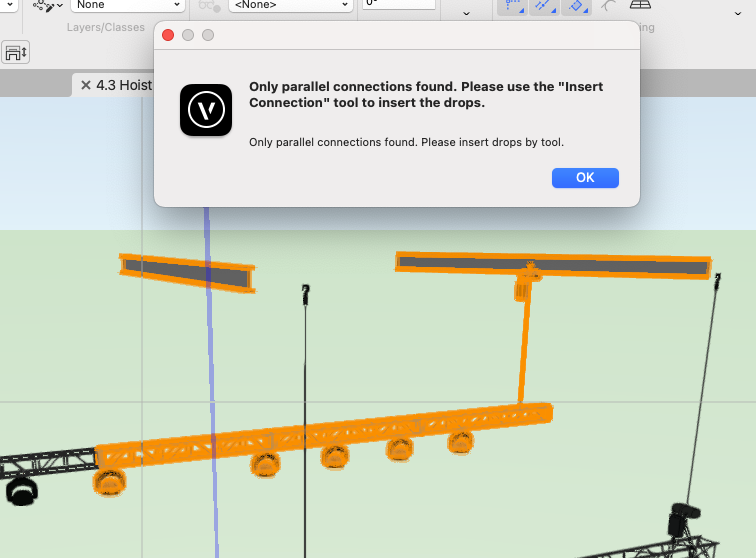

In exercise 4.3 - hoist challenge, one of the challenges is to connect a stick of truss to a structural beam via a drop.

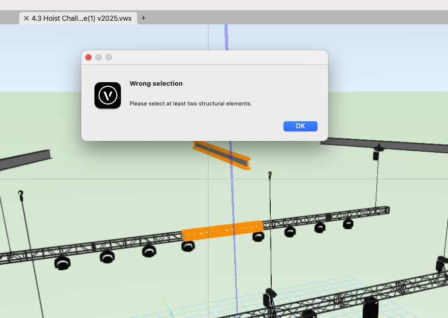

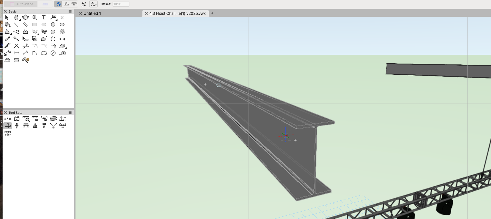

I cannot get the drop tool to select the beam, I also cannot insert a drop from the Spotlight>Rigging/Braceworks>Insert Drop drop down. Am I missing a step or doing something wrong? I am a new user so hoping this is just operator error.
Screenshots and file attached.

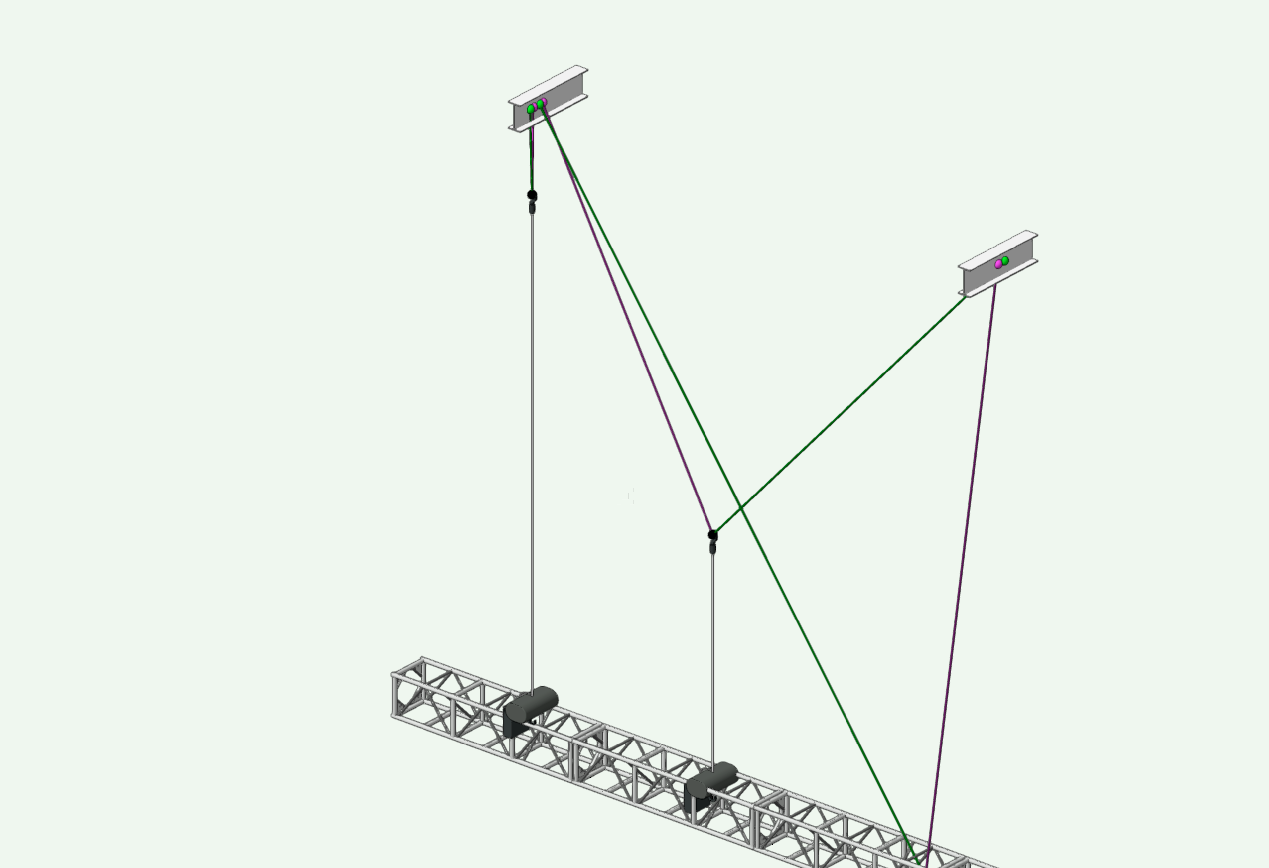

Just throwing this out there - you can use the Bridle tool and connect the truss to 2 adjacent points on the same beam. Make your down-leg almost the same height as the drop you want, and then choose the "replace downleg with hoist" from the OIP. This will technically give you a bridle on the same beam where the legs connect 1" apart... but it will also give you the desired visual of a chainhoist connected to a structural member.
It's a good visual tool for communication with the House rigging team/PE/AHJ... coupled with what @msharon said about conveying the load information to House/PE/AHJ.
