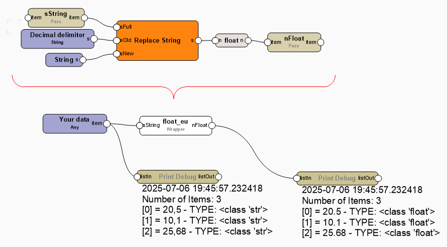

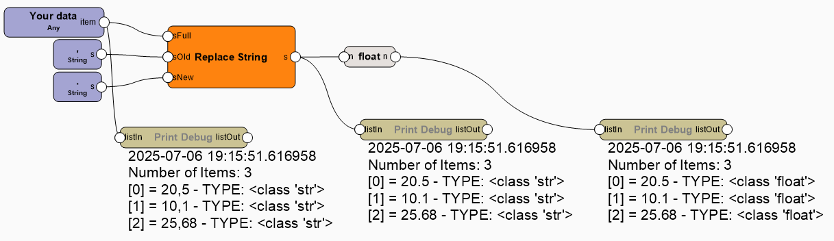

preparing data that is stored as a string for conversion is just a normal thing that you have to deal with when writing code (or like in this example making a Marionette). And as you already pointed out you can use the "Replace String" node to do that. There should be basically no difference between using the "Replace string" node to replace "," with "." and a modified "float" node that does the same thing but with a line of Python code inside the "float" node.
As long as your data is consictent (in this case this means that every "," in your data is a decimal delimiter), you should always be able to convert it to whatever format the "float" node needs to be able to convert it into a float with some Marionette nodes.
Here is an example of how i would do it with Marionette, but i think you already figured that our by yoursef.
By the way, if you need to use this alot, you can combine these few nodes into a Wrapper. The Wrapper looks like a single node and also can be used as such.
Here is an example of said Wrapper, how to set it up and how to use it.

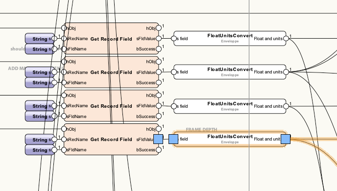

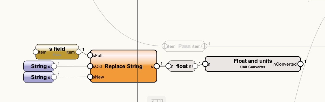

A I said previously this is very tricky specially when using home-made data bases because nothing changes in the figures. I realized that the symbol images kept their inch dimensions and applied them instead of converting them in cm.
As the object library extend it becomes crucial to look for those “problematic” nodes that refer  to external strings or data bases.
I built an enveloppe  node (Letti R advice) that makes the script works.
