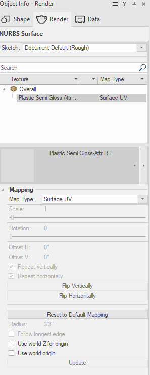

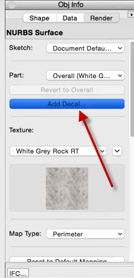

Shortnort Posted July 4 Share Posted July 4 I have followed the video exactly, but my OIP never has a decals palette. I extracted a face of an object, moved it slightly away from the object, etc..... Shows as a NURBS object. But no "ADD DECAL" pull down like in the video... What am I doing wrong? Quote Link to comment
Tom W. Posted July 4 Share Posted July 4 Right-click on the texture then 'Add Decal...'. Think the button was removed a couple of versions ago. 1 Quote Link to comment

Shortnort Posted July 5 Author Share Posted July 5 Thanks, Tom. Zoomer - there are videos on the 2025 help site. However, the video is NOT what actually appears on my screen. Quote Link to comment
Tom W. Posted July 5 Share Posted July 5 22 minutes ago, Shortnort said: Thanks, Tom. Zoomer - there are videos on the 2025 help site. However, the video is NOT what actually appears on my screen. Many of the videos on the help pages are not up to date. 2 Quote Link to comment
