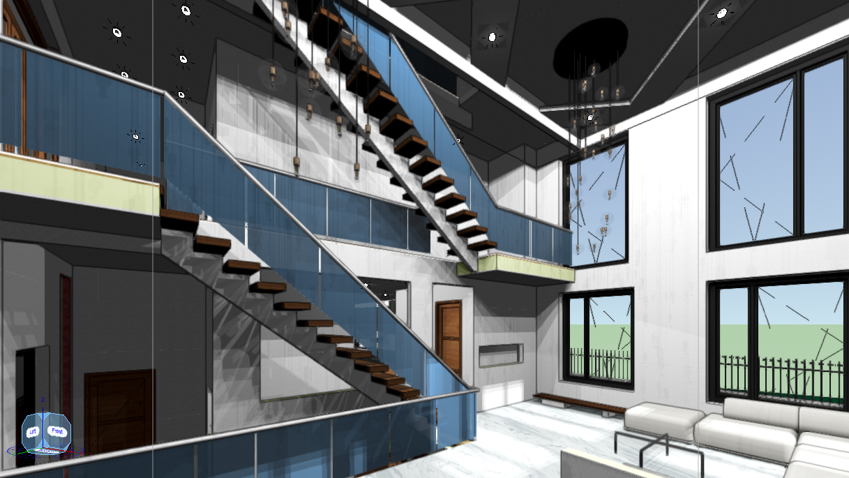

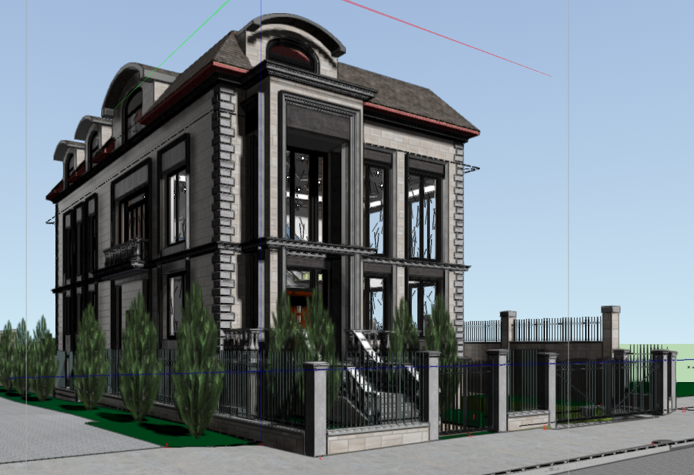

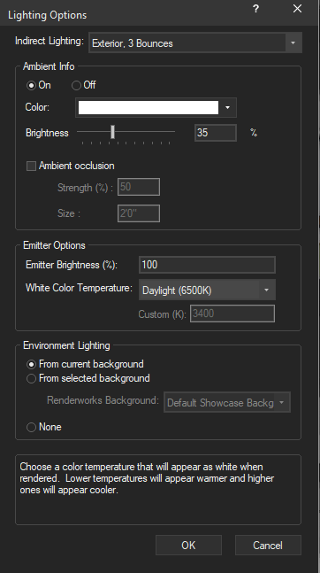

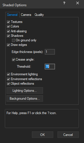

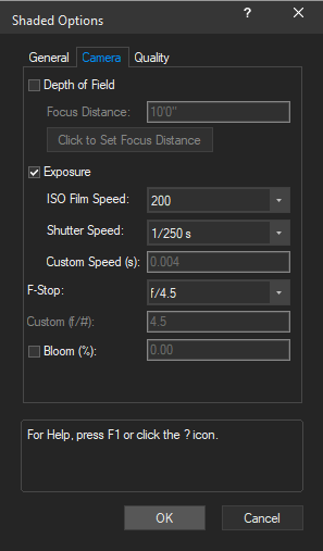

I'm looking to buy a new graphics card for VW. Lately, its been a bit sluggish when working in shaded view on a complex model. It also has lights with shaded elements turned on. Granted I have 3 monitors, and 2 viewports working in tandem to update elements on different layers or sheet layers. Generally I use viewports to work on multiple layers at the same time while looking at the model in real time to see how it looks. Here is a screenshot of the model
Currently I have the RTX 3070. it currently has a vram of 8gb and ryzen 9 3950x processor (16 cores) with 128 gb of ram. VW is installed on a solid state drive that should be fast enough to run. Generally, I don't have any issues when running VW2025, however, when shading and shaded
