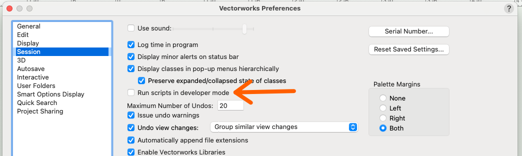

Pat Stanford Posted Monday at 03:39 PM Share Posted Monday at 03:39 PM While I don't know what the best editor is for Windows, but have seen recommendations for UltraEdit and NotePad++. And I would take a close look at Andrew's suggestion also. There is really not a development environment. The basic procedure is to the built in editor to create a very basic file with one or more {$INCLUDE} lines specifying the files you want to include in the script. Then use the external editor to edit the scripts. There is a toggle in VW Preferences for Run Scripts in Developer Mode that will force the script to recompile before each run. This will make VW recognize changes made in the external files. So the basic workflow is: Create Script with at least one {$INCLUDE}. I like to put the top level script outline in the file also Procedure Test; {Comments go here} {$INCLUDE} Run(Test); The Include file(s) will need to have the Begin/End statements necessary to be syntactically correct inside that scope. Edit the include file(s) in an external editor. Run the script (double click from a script palette) to for a recompile and run. Compile errors will show up and can be reviewed in the error message. HTH 1 Quote Link to comment
