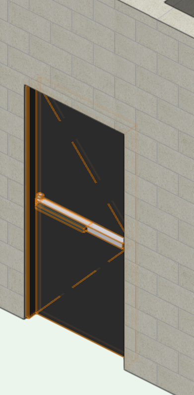

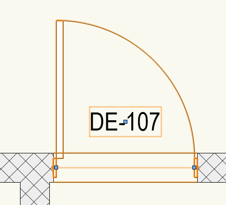

GregG Posted Tuesday at 08:22 PM Share Posted Tuesday at 08:22 PM (edited) How to get the panic hardware on the proper side of door? Flipping the door and/or reversing wall sides makes no difference. Panic bar stays put. Edited Tuesday at 08:22 PM by GregG Quote Link to comment
rDesign Posted Tuesday at 08:53 PM Share Posted Tuesday at 08:53 PM (edited) See related thread reporting this back in Vw2024, I don’t know if it has been fixed in Vw2025. If it hasn’t been fixed, it sounds like you need to make a copy of the panic hardware symbol and flip it. Edited Tuesday at 08:56 PM by rDesign 1 Quote Link to comment
GregG Posted Wednesday at 01:34 AM Author Share Posted Wednesday at 01:34 AM Thanks for the link. Small but very annoying problem. Makes the drawings look amateurish. Especially when the one contractor who doesn't like to follow the drawings points to a spot like this on the elevations! It may be a "small" bug but with real world implications. Quote Link to comment
Tom W. Posted Wednesday at 04:38 AM Share Posted Wednesday at 04:38 AM This was a brief bug but I believe it is fixed so @rDesign is right, you simply need to edit the symbol + flip the geometry about the origin. Quote Link to comment
