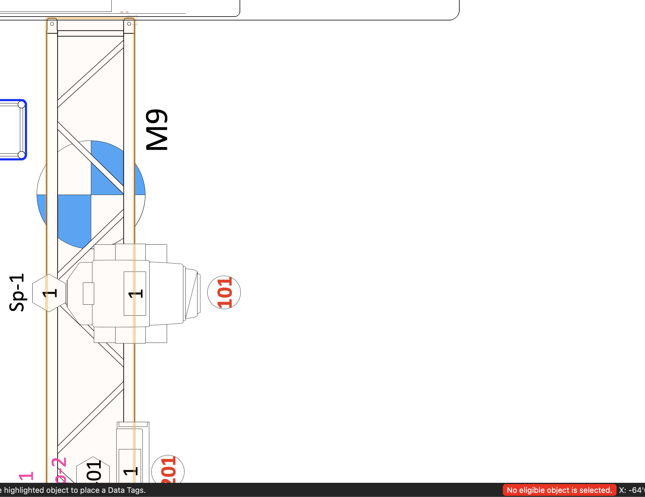

Iainy1 Posted June 9, 2025 Share Posted June 9, 2025 For the life of me I cannot figure out how to add a data tag to a truss hanging position. I have tried the custom tag option but there is no option for trim height. Is there a workaround or do I have to remove my hanging positions to make this work. Thank you Quote Link to comment
Vectorworks, Inc Employee Scott C. Parker Posted June 9, 2025 Vectorworks, Inc Employee Share Posted June 9, 2025 Have you tried the hanging position data tag from the VW resource manager? You could use it as a starting point to build your own custom data tags. Quote Link to comment
Vectorworks, Inc Employee Scott C. Parker Posted June 9, 2025 Vectorworks, Inc Employee Share Posted June 9, 2025 Please post a sample file so that the collective can take a look. Quote Link to comment
Iainy1 Posted June 9, 2025 Author Share Posted June 9, 2025 Sorry, I just figured that out. I have the hover over the center of the truss and not the truss itself. I am now trying to add length and type to the tag, this is proving a challenge. Thanks for your replies though. 1 Quote Link to comment
Vectorworks, Inc Employee Scott C. Parker Posted June 9, 2025 Vectorworks, Inc Employee Share Posted June 9, 2025 27 minutes ago, Iainy1961 said: I have the hover over the center of the truss and not the truss itself. Ah, yes. There's a funny thing about hanging positions. In this case, you're actually hovering over the HP rather than the truss. Quote Link to comment
