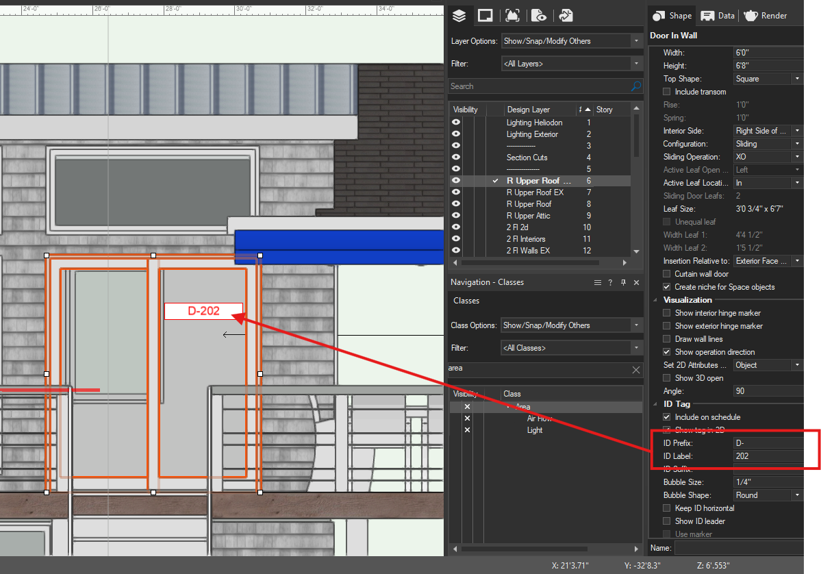

Milindsinh S. AKA Milu Posted June 4, 2025 Share Posted June 4, 2025 Hello Forum, I'm trying to create a Data Tag that displays the ID Prefix + ID Label of a Door or Window. I’d like to make it universal, so it works for both Doors and Windows using the same tag style. I'm not sure how to set this up properly — does anyone have any ideas or experience with this? Any alternative method to achieve the same result would also be appreciated. Thanks in advance! Quote Link to comment

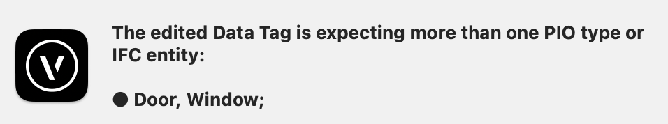

Tom W. Posted June 5, 2025 Share Posted June 5, 2025 1 hour ago, Pat Stanford said: Try this. Instead of using the WS_IF, I used the Trinary Operator with a blank "OR" section. I don't know how to test if the link is working properly as I don't use that functionality. #Door#.#IDPrefix##Door#.#IDLabel#->#Door#.#IDLabel##Door#.#IDSuffix#@#Door#.#IDLabel#<>'': #Window#.#IDPrefix##Window#.#IDLabel#->#Window#.#IDLabel##Window#.#IDSuffix#@#Window#.#IDLabel#<>'': Again, the entire formula should be on one line (other than automatic wrapping). Thanks Pat this doesn't work unfortunately because the Tag thinks it's looking for an object which is a Door + a Window at the same time: I notice the formulas I gave you earlier were wrong so this is what I am using: #Door#.#IDPrefix##Door#.#IDLabel#->#Door#.#IDLabel#@#Door#.#IDLabel#<>'': #Window#.#IDPrefix##Window#.#IDLabel#->#Window#.#IDLabel#@#Window#.#IDLabel#<>'': I don't fully understand why your first Tag - using #WS_# - is happy looking for Doors or Windows whereas the second one isn't...? 1 Quote Link to comment
Milindsinh S. AKA Milu Posted June 10, 2025 Author Share Posted June 10, 2025 #WS_IF(OBJECTTYPENAME='Door', CONCAT(Door.IDPrefix, Door.IDLabel, Door.IDSuffix), '')##WS_IF(OBJECTTYPENAME='Window', CONCAT(Window.IDPrefix, Window.IDLabel, Window.IDSuffix), '')# Thank you. This one by @Pat Stanford works perfectly fine, and beauty is that is doesn't recriminate between door and window.. also thanks to @Tom W. for follow up. Quote Link to comment
