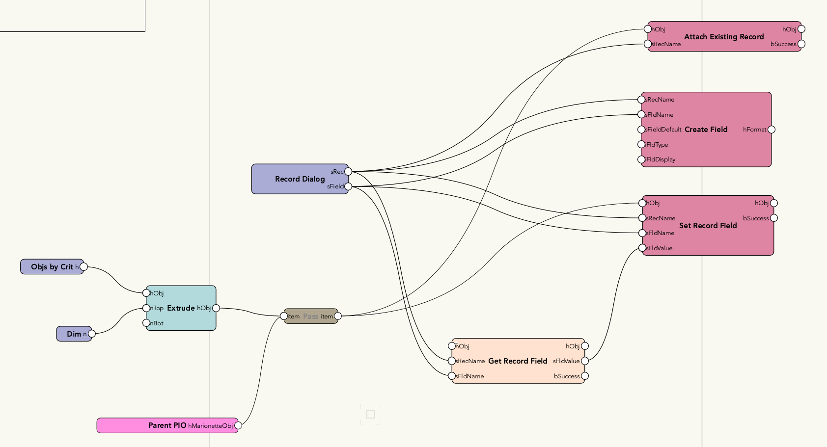

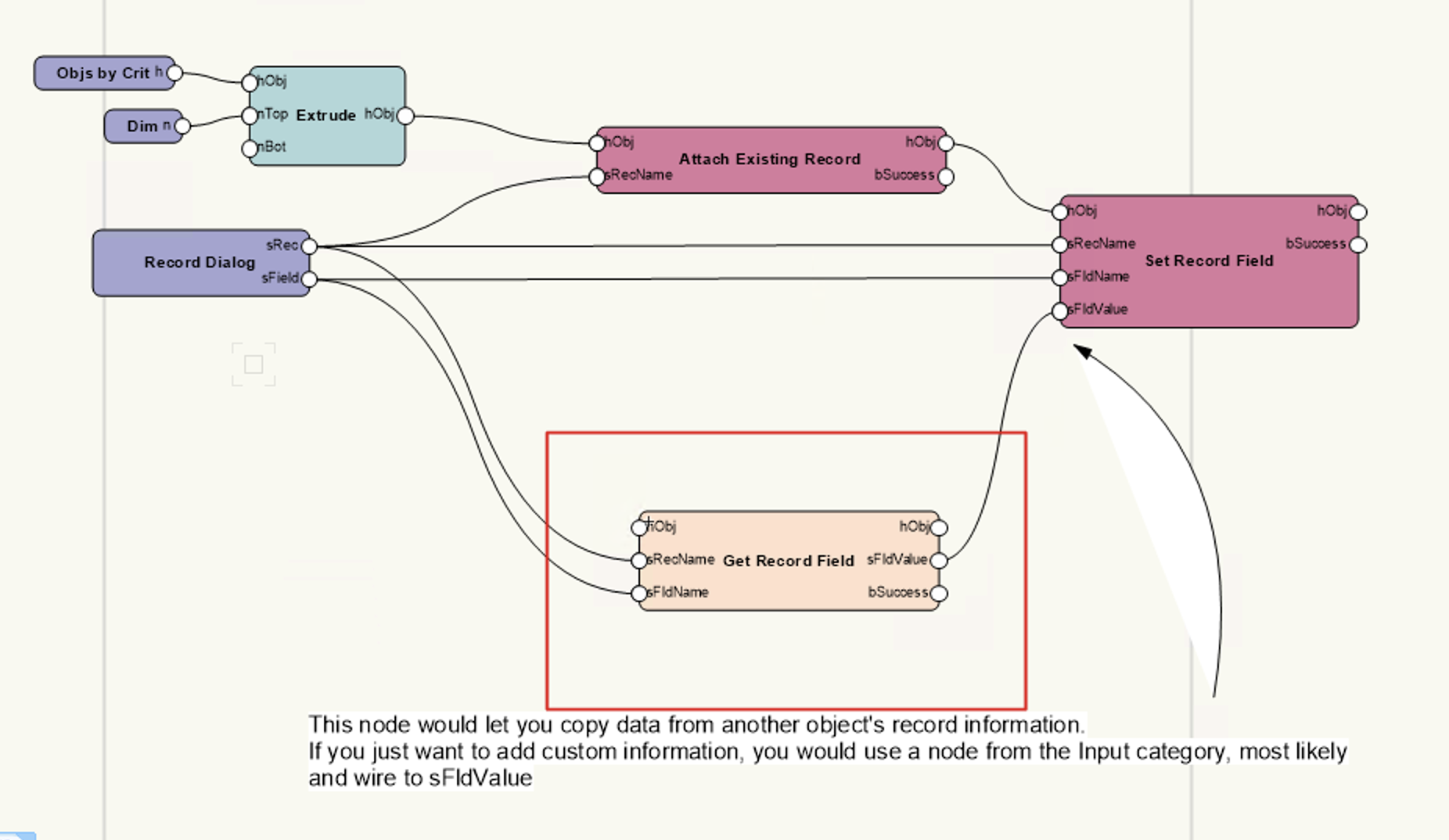

Marionette Maven Marissa Farrell Posted May 30, 2025 Marionette Maven Share Posted May 30, 2025 So - my understanding is that you want to extrude a shape and attach information to it. Your file already has the poly extruded, so I am unable to see if it already had the record info attached. For Menu Commands, you will never need the Parent PIO node. That is only if you're creating a Marionette object. Here's a screenshot with some wiring modifications that might help you along. It's hard for me to test without the referenced database, and I'm not sure where your data should be coming from, so if you could give more info there that can help. Quote Link to comment

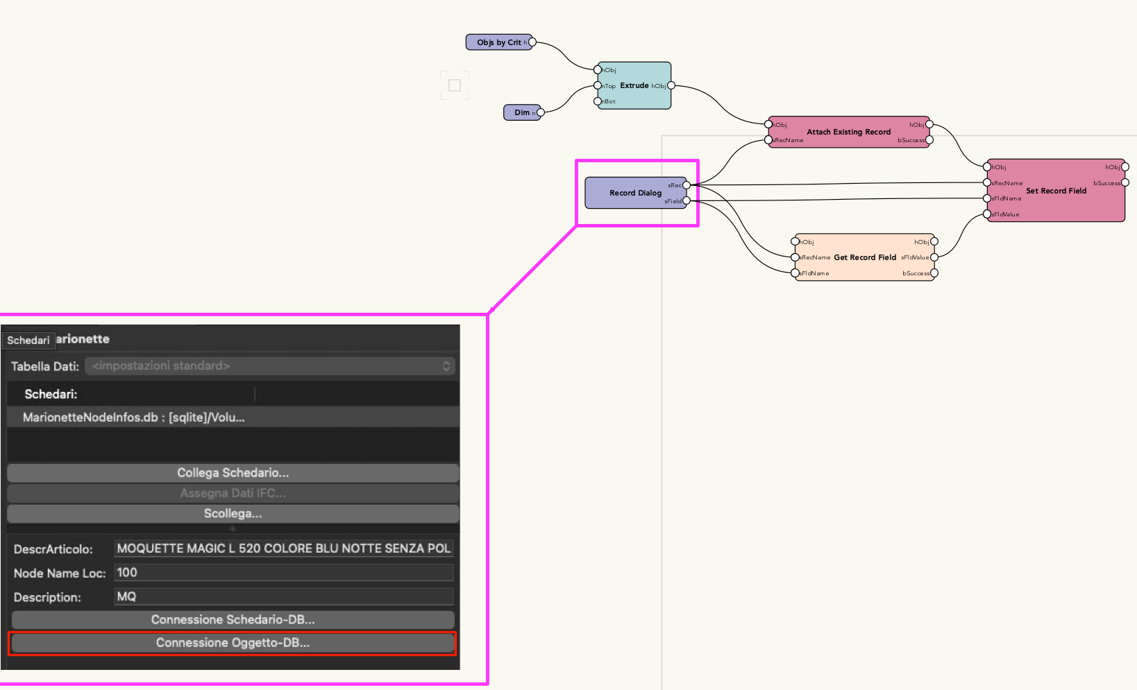

Giobbe Posted June 3, 2025 Author Share Posted June 3, 2025 Hi @Marissa Farrell Yes, it worked before and linked the record, but what it doesn't do is link the information from the database into the record dialog ("descrarticolo","Node Name loc" and "description") inside the file zip, we have at DB.squlite file Why? Can't it do that? Archivio.zip Quote Link to comment
Marionette Maven Marissa Farrell Posted June 3, 2025 Marionette Maven Share Posted June 3, 2025 Ah, okay, so you have a Database Connection. Currently we don't have nodes that support that, I made these back in 2016, and haven't looked at them since, maybe they will be useful? They're pretty ugly, but hopefully can supply the functionality you need... 2 Quote Link to comment
