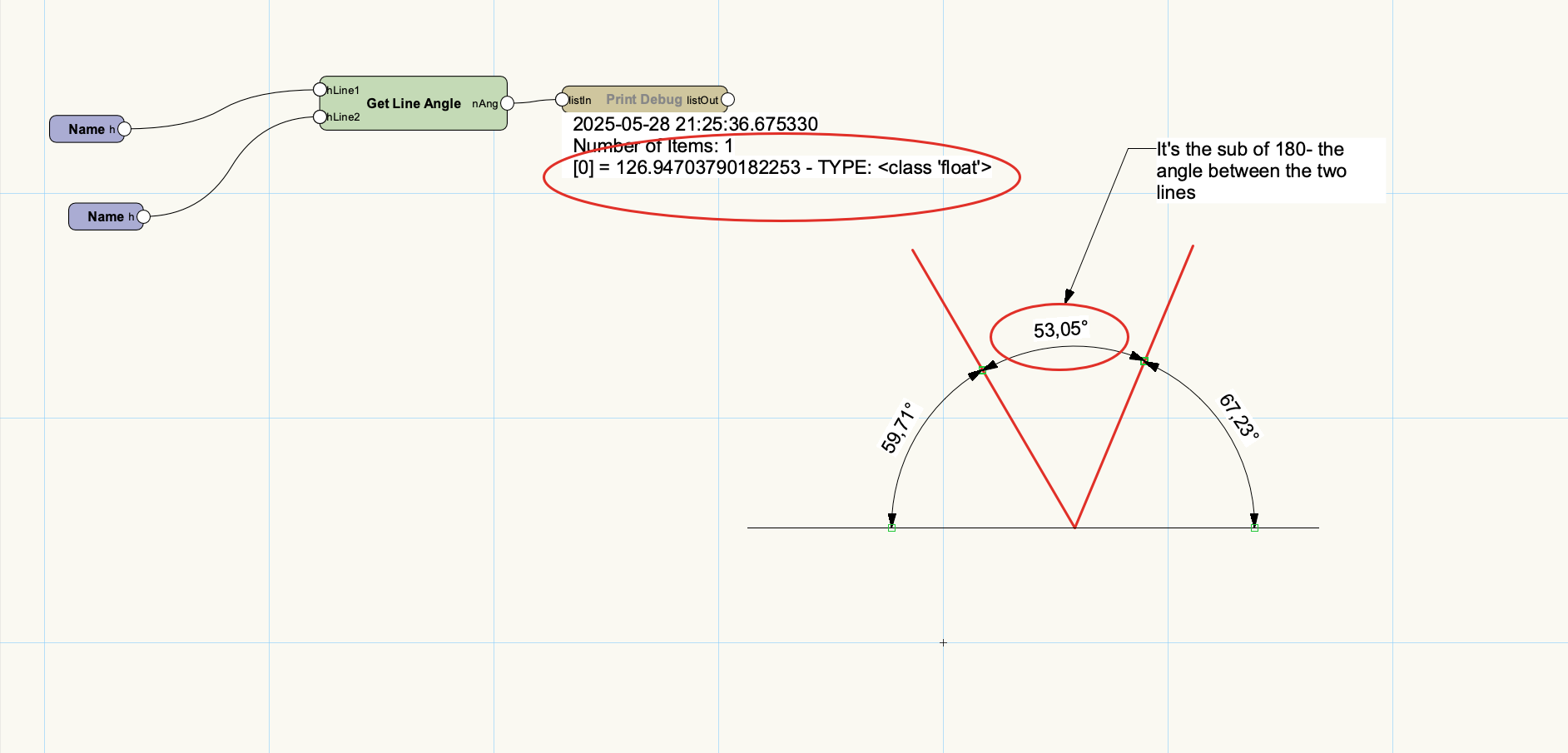

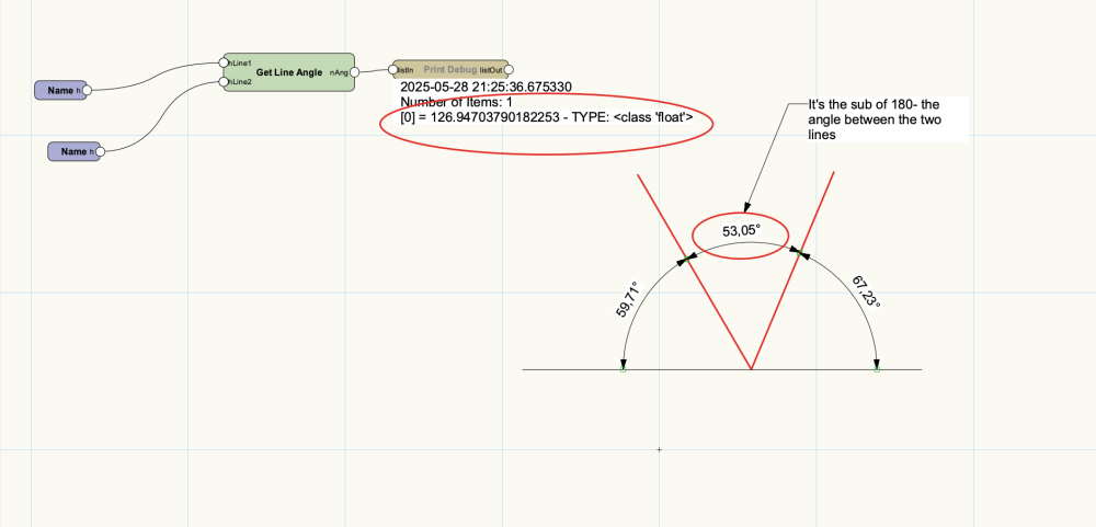

Laurentbiotopes Posted May 28, 2025 Share Posted May 28, 2025 hello , the "GET LINE ANGLE" give the angle between two line only after a sub of 180 ... is there a node without this calculation? Thanks Quote Link to comment
Letti R Posted June 2, 2025 Share Posted June 2, 2025 Hello, i think "line" in the title of the node refers to the mathematical meaning of "line" (a straight that extends endlesly in both directions). Therefore two lines, if they intersect, always have two different angles between them (if not perpendicular) that add up to 180°. From the code of the node you can see that this node always calculates the "obtuse angle" and not the "acute angle" between the two lines. Regards, Letti 1 Quote Link to comment
