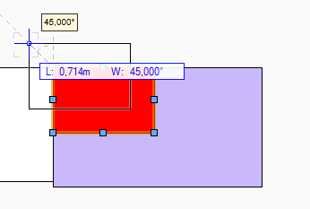

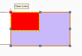

One problem I find with working in VW is that moving/selecting objects does not work optimally.
For example, here I want to move the blue selected rectangle by its top left vertex. However when I click, the object being moved is actually the highlighted red rectangle. This seems a little unnessersary because it can be assumed, once you've selected an object, it is what you intend to move.

I agree - it would not be unreasonable for the SmartCursor to assume that the selected object is the one you intend to move. That seems like a nice improvement. There are two solutions, which would be 'workarounds' - Change the drawing order of the blue rectangle using the Send commands or use the Move By points tool.
Screenshot2025-05-21132341.png.70637d98628442bd587d3ef6dec28085.pngScreenshot2025-05-21132410.png.a14e4d1d569748039921d6f99609eb64.png
That's how VW unfortunately worked in the past.
That was fixed at one point around VW 2017 or so and worked well over years.
Until a regression in VW 2024 (?) or 2025 - now it's broken.

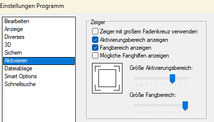

The second point I found out can be remedied by scaling up the activation area of the cursor in program settings.
