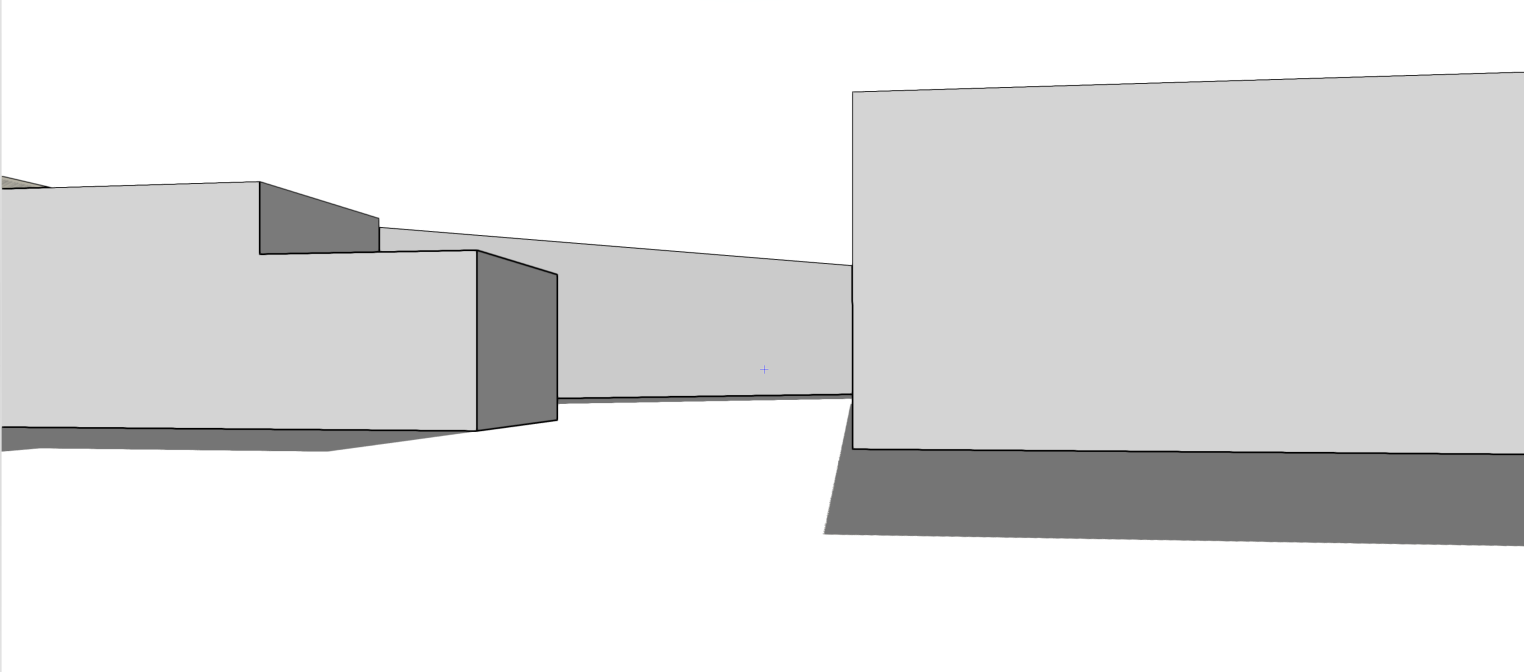

Yuju94 Posted May 12 Share Posted May 12 I was making shadows on a 3D model in shaded and somehow managed to change only the color of the shadow without changing the color of the light source. But I can't remember how to do it again. Please tell me how to change only the color of the shadow without the light source. Quote Link to comment

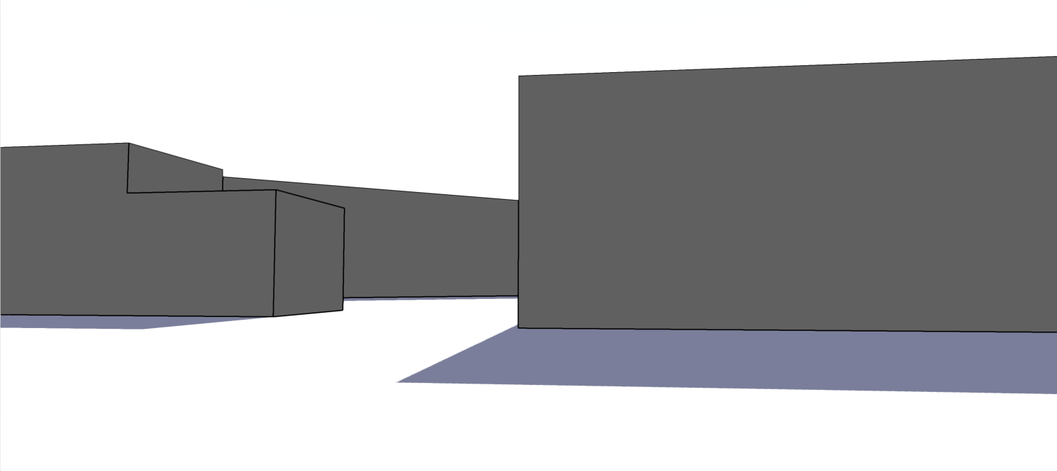

Yuju94 Posted May 12 Author Share Posted May 12 Hi @Dave Donley Thank you for your reply but it doesn´t work... Quote Link to comment
Vectorworks, Inc Employee Dave Donley Posted May 12 Vectorworks, Inc Employee Share Posted May 12 @Yuju94 If you set ambient light brightness to something like 20-35% and ambient light color to blue I would expect it to look like your image above ^. There is also an Artistic Renderworks Lines and Shadow render mode that can produce a look like this, where the shadow color is controllable. Quote Link to comment
be4 Posted May 13 Share Posted May 13 hello, I found one dialog for setting the color of shadows, in German it is called »Malstil«, sorry, I don't know the name in the US version, so, if you choose »Malstil« for render options, there is a style called edges and shadows, there you can set a color for shadows. 2 Quote Link to comment
Tom W. Posted May 13 Share Posted May 13 56 minutes ago, be4 said: hello, I found one dialog for setting the color of shadows, in German it is called »Malstil«, sorry, I don't know the name in the US version, so, if you choose »Malstil« for render options, there is a style called edges and shadows, there you can set a color for shadows. This is Artistic Renderworks Lines + Shadow that @Dave Donley refers to above 1 Quote Link to comment
